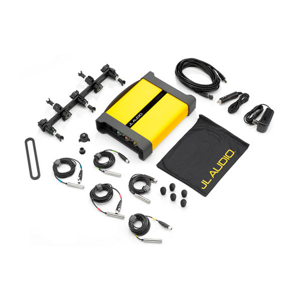

JL vxi is also nice stuff. All channels driven are the power ratings and usually under rated. The guys that designed all the cool old school amps (PPI, Xtant, etc) design these ones. DSP with measurement software overlay and control via tun 4. Upgraded multi mic system that can also be used with the JL MAX measurement system (not cheapest) but WAY cheaper than Klippel/AP stuff!
They also are network capable up to 10 amps via the vxi hub so you can control over all of them with a single USB cable.
