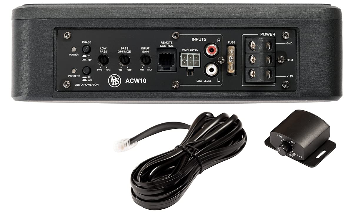

Here is another example:
Helix:
SSL:
DLS:
Phenix Gold:
Blam:
