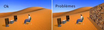

We're not agreeing on that listening outside point though, which is OK, but I've said why I don't agree with that so that's fine.
Illustration by Mr Jean Pierre Lafond (expert "construction theater ... & studio").
It's only logical once you understand how reflections, modes, etc. work. Walls are obstacles that prevent you from hearing the speakers. (modes, reflections, reverberations, and a host of problems => the reason for the arrival of acoustic treatment.
Now, if you remove the walls = no more problems.
You'll hear the direct sound of your speakers.
Try it and see for yourself.
There's a difference between words and actions. If you follow my advice, you'll see that these are real facts.
(You will get a significant gain in the performance of your speakers by playing them outdoors)
The reason studio or hi-fi (indoor) speakers aren't considered for outdoor use is that they're optimized for indoor use. (Design , living room adaptation, etc.) That's where it ends. Regarding the sound itself, there's no miracle; if you put them outside, you'll hear them better than indoors (direct sound).
Except you'll have to carry the amp, the cables, etc., it's not suitable for this use.
Likewise, playing loudly outdoors requires more watts (with professional use (festival etc.)) with large woofers and more massive speakers, compared to speakers for small rooms.
Why is the sound already better in large rooms without acoustics? (compared to small rooms)=> Even if it would be better, the problems will still exist; acoustics are a must.) => Most of the waves ((mid and high frequencies) manage to develop before hitting an obstacle, except for low-frequency waves like 20 Hz, which are quite long The bass (low frequencies) is the element to be addressed first (the most disruptive).. As well as absorbing early reflections. While diffusing the room to the ceiling and rear (essential in homes).
I would like to point out that we cannot have absolute treatment, it is worse in small rooms, nevertheless, we can improve the quality by treating the walls well => doing the best we can, it is already satisfactory
Outside, without walls, there's no need for treatment, as explained above. (Better sound quality, and free ^^)
=> You receive the true sound coming from the speakers (faithful) because there are no obstacles (bare walls and various room size issues, etc.).
Here, reflections, etc., will never return to you.
You will get the most natural sound from your speakers. (Direct Sound)
It's above all intimate. So we have no other choice but to study and then (acoustically) treat our room to hear the direct sound of the speakers. Simple.
It's the basis of everything.
Owning high-end speakers without treating your room is like driving a Ferrari on a muddy road. => You must follow the steps and prepare the path before purchasing the speakers in order to be able to use them.

To get back to the topic, giving feedback on your speakers in rooms that haven't been treated or haven't been treated well is pointless (you hear the walls, not your speakers).
Not to mention their placement, as you can see in some photos (there are criteria to follow first and foremost => mandatory. Even if you haven't treated your room yet, at worst).
The reason I'm urging these people to use their speakers outdoors sooner is to remedy this in the meantime, so that you can give your feedback on the JBL 308P MKII, for example.
That was the point of my message, not to have you install your speakers outdoors forever. (Just for testing your speakers, "hearing it")
Reflections aren't always a big deal and you don't need to eliminate all reflections, that's why having good directivity is important, which these speakers actually have, so they can sound good in rooms. You don't need to know how the speaker sounds outside, and it's also not a practical test for the reasons I mentioned earlier. Anyway, I'm done now.
"It's time to wake up to the harsh reality of sound)"
Sorry, but reflections/waves are the major sound problem in a room. We can add the room's configuration to this. However, in most homes, we have no control over anything; we just make do. Acoustic treatment is the main factor in correcting room problems. Not the right directivity (speakers)... no matter how good it is. It won't correct reflections/waves.
A study should be considered first.
(You can't drive a Bugatti through the mud.)
Especially the bass (place full-range bass traps in the back corners of the room first and foremost) (Have an absorption coefficient descending to less than 100 Hz and of large thickness => 40cm minimum = rear corners of the room (bass trap cubic shape > triangle).
You should know that you can't work miracles in a small room, but you can always reduce the negative impact of the bass (destructive). The JBL 308p MKIIs extend low into the bass frequencies for a bookshelf speaker with an 8" driver. They won't have a good impact in a small room that isn't properly treated, because they're omnidirectional. (My main reason for this intervention)
The treble and midrange are easier to address, as well as early reflections (which are mandatory) because the waves are directional (laser).
Diffusion (thick diffusers) is also mandatory in rooms, especially on the ceiling and rear walls of the room, to preserve the sound.
All of this contributes to being able to hear and enjoy the direct sound of the pair of speakers as much as possible. As if you were listening to the speakers outside => the sound we are looking for in a room (see image below)
At no point did I say that "it's not necessary to eliminate them all" (reflections); we absorb them intelligently (listening area), not everywhere. I also specified the addition of diffusers in key locations. Don't invent anything. What I didn't say, I see that you're being dishonest, and that you refuse to admit that I say a lot of good things here.
Diffusers will bring/keep energy into a room and much more (life)

Acoustic treatment and room layout characteristics are the most important.
I won't even mention insulation, which is beyond the reach of amateurs (construction), especially for home theaters.
Good evening. (Peace)
PS: There are a lot of professional studios etc. that are rotten. Above all, don't be fooled by "the appearance".
Illustration by Mr Jean Pierre Lafond (image above) Racing car driving in the mud = of a pair of speakers in a room not treated (acoustics)
Neutral speakers = last link (icing on the cake) (after the steps described) [The road must be built before the car can be driven in good conditions.]
