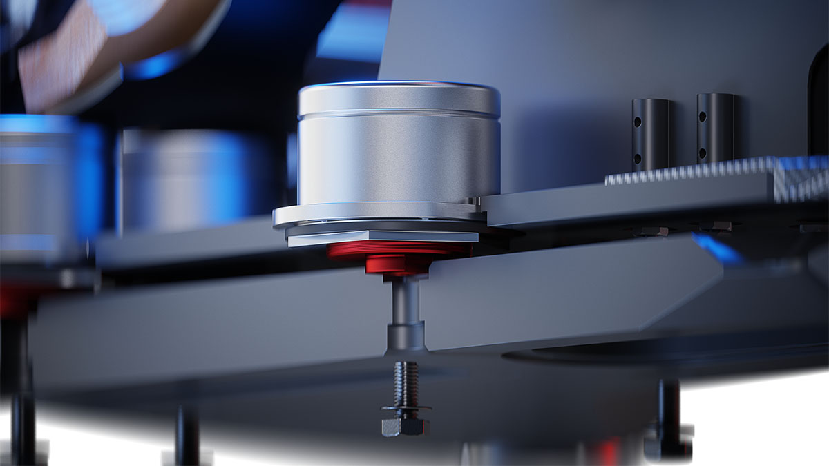

IsoAcoustics Isolation Feet - Does it really make positive effect or fancy accessories
This is what Iso Acoustics is telling about speaker resonance:
Manufacturers will say anything, visco-elastic material ( open cell rubber /Sorbathane) is an excellent isolator you just need to decide upon the ‘stack’ height and durometer which depends upon the weight of the speakers.

I used to have two KRK monitors on my desk - the whole desk resonated along with low bass. It's a possibility to put them on stands next to your desk, but I put the IsoAcoustics underneath to try them out. Must say, was much better. Better defined bass. The desk rumbled along before I guess. No before/after measurements, sorry.
Now I've got Genelec 8030C. They have their own rubber feet, which works great as well. Must be something to them, if a brand like Genelec uses these, also on the Ones.

I’ve seen quite a number of people who said that, aside from any effect on the sound, the Isoacoustics footers clearly solved some vibration issues they had with gear such as subwoofers (cutting down transferred to the floor, or speaker vibration, causing rattling, etc.)
I just got ISO Acoustic ISO 155 stands for my desktop setup. It made a HUGE difference. I was using foam before but the bass was still transferring to the desk and creating unwelcome resonances. After installing them I was setting up my subwoofer again and testing pink noise with my RTA app. To my surprise a ton of bass frequencies were missing that were there before. I was able to turn up the crossover setting of my subwoofer to compensate and the sound is awesome now.
