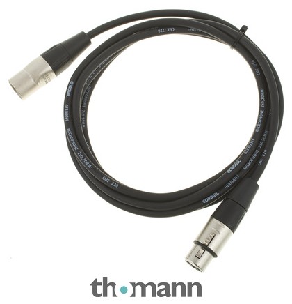

Which cable looks the best?
Since you're not going to hear a difference between cables in this application, looks or price are the only two criteria. If fancy looking cables float your boat, buy the ones that you think look the most impressive.
BTW, if looks are not important: there are cheaper options out there, but you'll be way past the point of diminishing returns with a pair of these.
