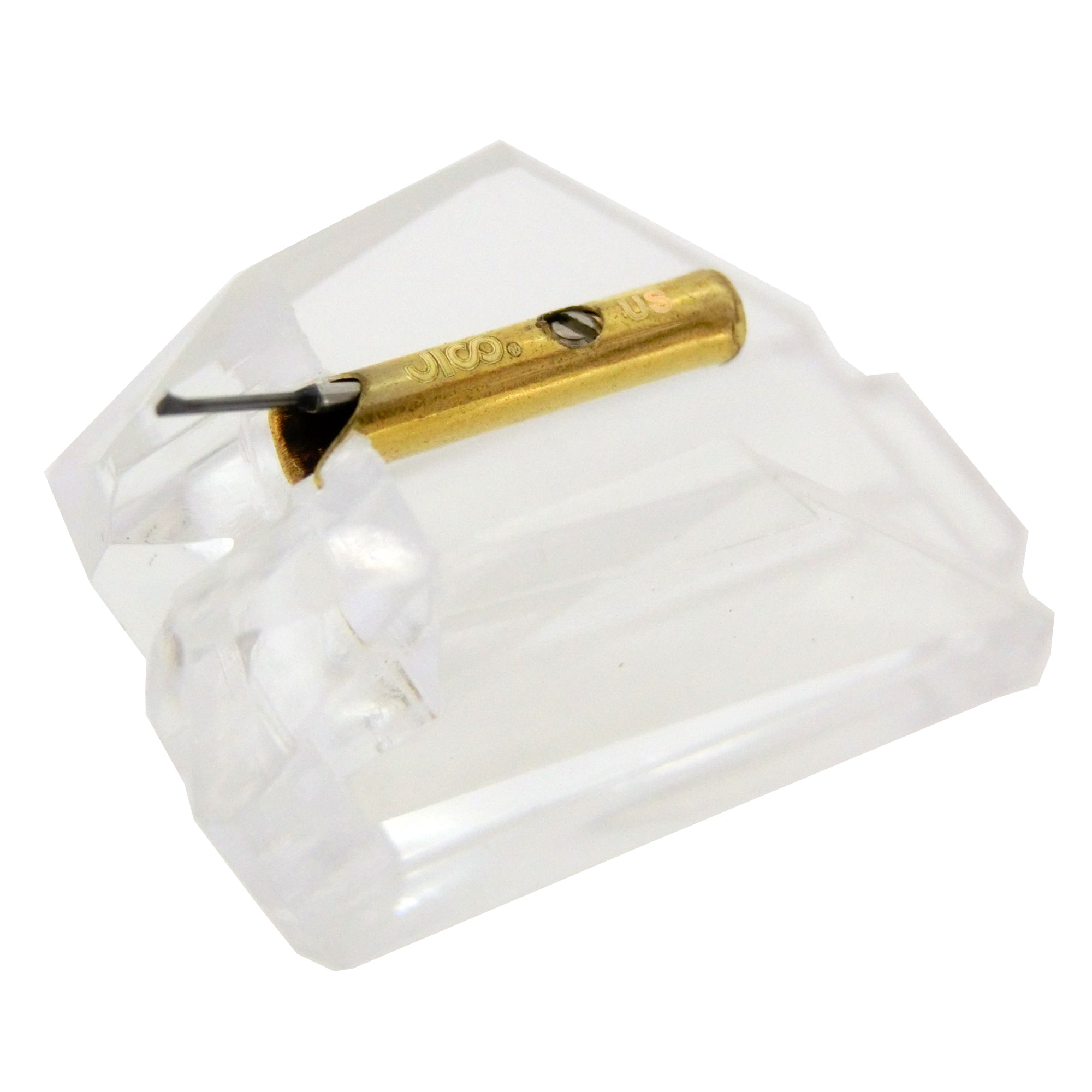

You need to make sure that the replacement stylus you purchase is high compliance as per the T4P specifications...
Most current tonearms are much higher mass than T4P specifies, and therefore most of the market is for styli with lower compliance... which won't track properly on a T4P arm.
Jico make good replacement styli but you need to be careful... here is an example..
This is a stylus for the very typical Technics T4P cartridges EPC-P55 (a very very common cartridge, sold under various brand names and model numbers)
But looking at the Jico specifications for tracking for.... it states 2.5g
From this you can absolutely tell that it is NOT designed for T4P - T4P tracks at 1.25g .... and tracking at 1.25g will require high compliance - any stylus with VTF of 2.5g is going to be a low compliance design, and will mate well with a heavy to mid mass arm.
I stress, this is likely to be a high quality stylus - but not appropriate for a low mass / P-Mount / T4P arm.

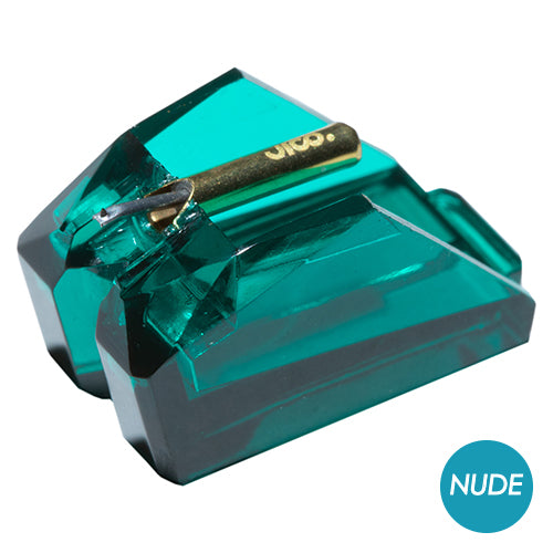

Here is another stylus from Jico, same fitting (so it is interchangeable with the previous one above) - but this one is specified with a tracking force of 1g to 1.5g.
This one is likely to work well in a T4P low mass arm.
They look the same, and without very close inspection, may not look different at all (ignore the colour, they are both available in various colours) ....
The former would work well in a "standard" tonearm, the latter will require a low mass arm or a T4P arm.
Yes this, and in addition some (Jico SAS is one unfortuneately) of the replacement stylus for p-mount are not compliant with the overhang dimension. This is an issue for p-mount linear trackers obviously.
