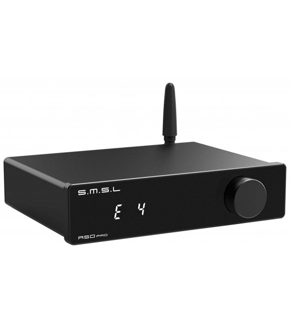

I would go with this SMSL A50 Pro for only 99 Euros and sold there in France...
It has everything you need and you have 100 euros left over in your budget to maybe add a passive subwoofer,
or maybe you could find some better speakers on the used market for that price?...
Here's a review of it...

Im curious about the A50 Pro negative opinions, can you post some links to them?
I've never understood the lack of popularity of pretty much all of the products sold that use the Infineon amp chips like the A50 Pro uses
My suspicion is it's because they are lower power and those people are using inefficient speakers.
I wonder the same thing about the TPA3221 chip used in the Fosi Audio MC331...is almost nobody using it just because it's lower power than the TPA3255 and most people use inefficient speakers?
So just for my own research since I'm also looking for a new integrated amp, anything below $300, I'm digging a little into the SMSL A50 Pro.
And as I said I don't believe that low cost necessarily means low quality sound, so I don't really care which amp is more or less expensive.
I'm always more than a little curious when an amp designer chooses another chip besides the TPA3255 that 95% to 99% of all class-d amps use, such as the TPA3221 chip used in the Fosi MC331 and the MA12070P chip used in the SMSL A50 Pro.
Both chips are a lot lower power than the TPA3255 but very well could sound better used within their intended power output range, which is likely easy with speakers of say 93db/1watt or greater sensitivity.
The MA12070P and the A50 Pro in general is an interesting design. The internal circuit board looks very empty. It doesn't have the common NE5532 opamp chips and many other larg capitors, inductors, and a big heat sink for the amp chip, etc... that most class-d amps have.
Internally it looks much more like a DAC than a power amp. When you research the MA12070P you learn why:
The MA12070P is a fully integrated Class D amplifier IC that uses multi-level switching technology for high power efficiency and low distortion.
It eliminates the need for many external components such as discrete op-amps, DACs, or analog amplification stages.
This integration leads to a much simpler, cleaner, and more compact PCB layout with fewer components visible.
The small board size and minimal components reflect the efficiency and compactness of the MA12070P’s all-in-one design.
Electronic volume control, crossover, and EQ are implemented digitally within the chip or via associated microcontrollers, not requiring external analog op-amps.
The implications of this are... 1)less manufacturing cost and so you can sell a product cheaper, and 2) there are less chips, capacitors, resistors, etc in the signal path (which is normally a good thing). Or at least less external things in the path. There is more internal things, inside the MA12070P chip itself. So the resulting sound could be better or worse depending on how well the chip has been designed.

And here below is a picture of the inside of the SMSL A50 Pro.
If you've seen the internals of many class-d amps and DACs you know how strange this looks for a loudspeaker power amplifier especially a 2.1 amp with powered sub-out. It looks unbelievably empty. And btw, the other side of the board has nothing on it except two small bars of aluminum that transfers heat from the two power chips to the case.
But I view this more as a possible positive versus a probable negative,
because when it comes to audio equipment I believe less is usually better than more.... less power, less stuff in the signal path, etc.
but... really to a large degree the question comes down to
how good sounding is the MA12070P amp chip and it's internal DAC ... if... it puts out enough power for YOUR speakers?
