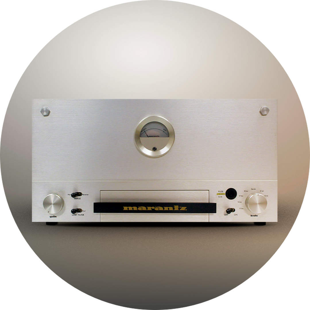

Beauty is in the eye and all that, I like the porthole cosmetic design which reminds us of the Marantz look from the famed
early Saul Marantz products. To my eye they look better than the same as, same as, same as, look of all the rest of the receivers, the ones where you have to get up close to read the corp name to know who made it.
"An Icon Of Design" as they call it." ;)
