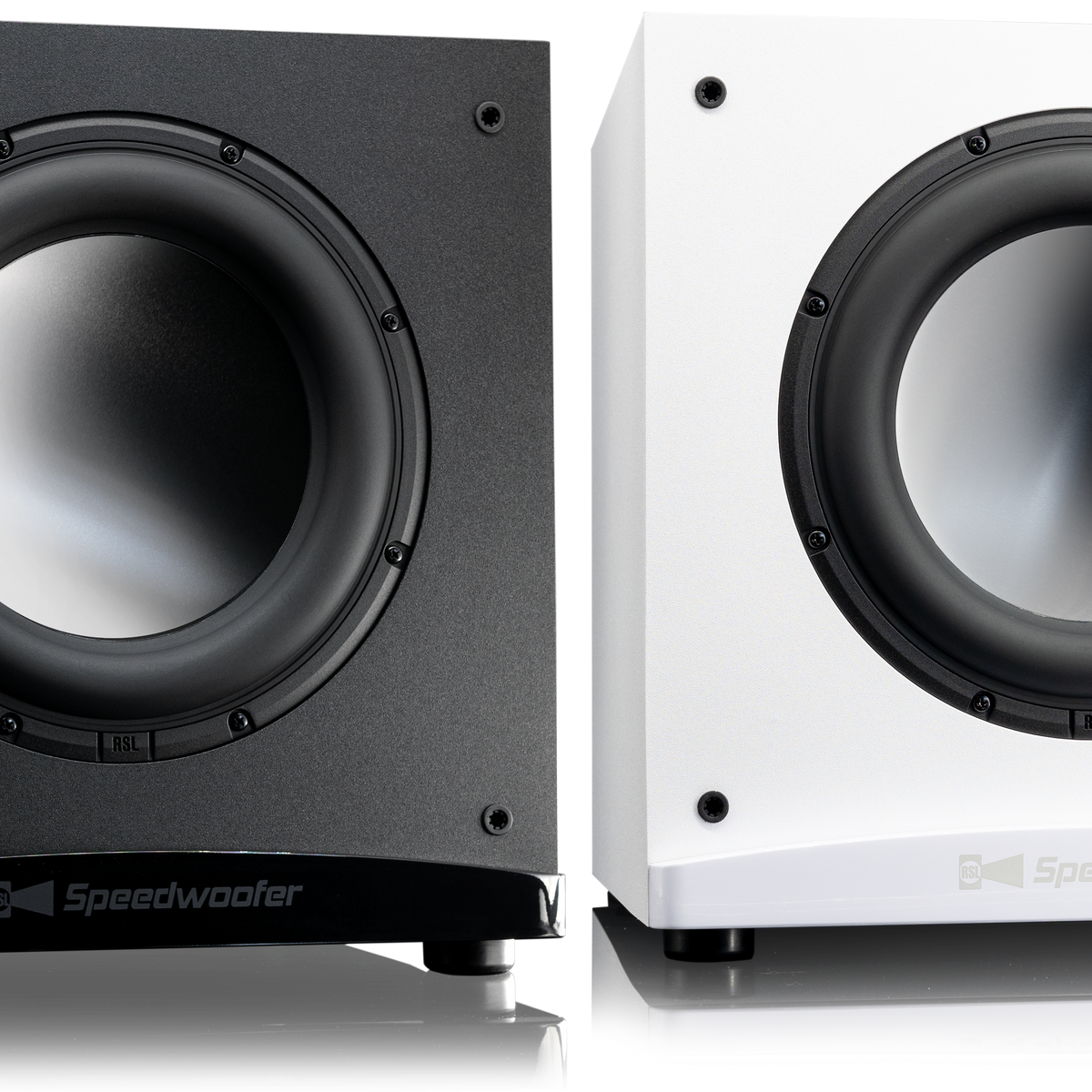

A new subwoofer is also worth considering. The PSW-111 has a relatively high port tune, a bigger sub would give you more bass extension and move the group delay peak away from the kick drum region. RSL 10S MKII or Klipsch SPL-120 are affordable examples.
