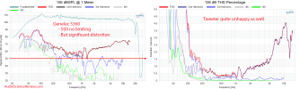

Keep in mind that while the 106 dB sweep on the S360 shows what looks like fairly high distortion, it actually remains under 1% THD from 200 Hz up through 3 kHz. Beyond 3 kHz, distortion does rise sharply, but it’s almost entirely H2, with H3 staying well under 1% across the range. That behavior is typical for compression drivers, and since H2 is generally considered far less objectionable than H3, it’s not something to worry about in practice. If you run a high-pass filter at 80–120 Hz, the distortion below 200 Hz drops significantly as well. So while seeing ~4% at 100 Hz at 106 dB might look concerning on paper, in reality it will be reduced with a HPF, often back into inaudible territory. For these reasons, I wouldn’t hesitate to say the S360 is fully capable of hitting very high clean levels in-room. For context, I’m running 8350s as LCR, and they have no issue reaching reference at my 2.5 m listening distance.
  • Genelec S360A S360 106 dBSPL THD Distortion Measurements Studio Monitor.png
