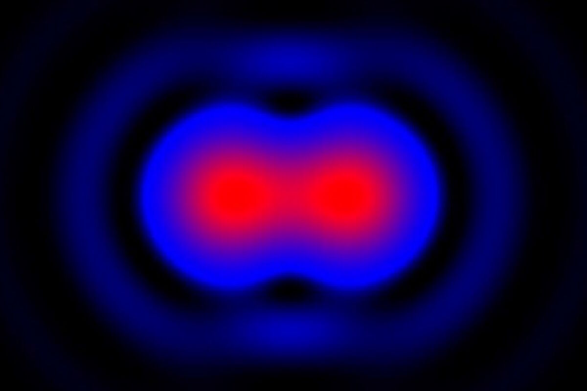

If audiophools were photo enthusiasts, they would unironically believe their hawk eyes made it possible to see beyond the resolution of the magazine print.
... and then there's the great practical joke of optics: empty magnfication. :)
d = λ/(2NA)
... and that's why we have electron microscopes :)
d = λ/(2NA)
