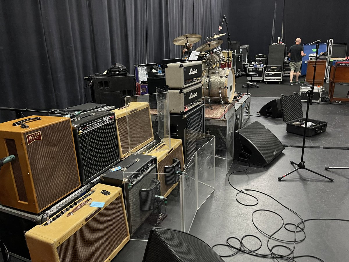

Not this guy, Bonamassa:
E7HiO3CX0AIb27O
All for one guitarist.
Nor this guy:
Eric Johnson switches between Marshalls, Fenders and Dumbles or in this case Two Rock, a Dumble based amp.
Nor this guy either:
But these guys, yes:
