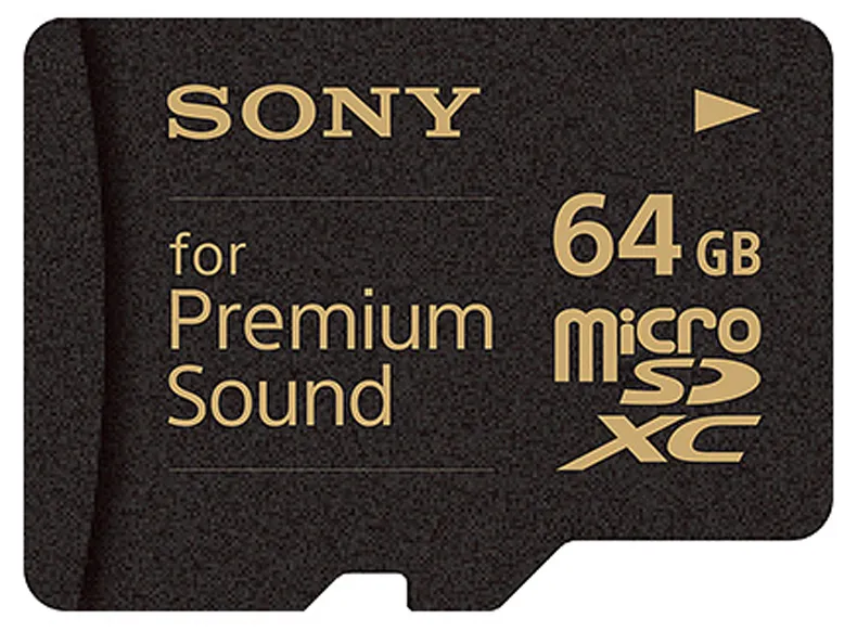

This is the kind of speed you can get in consumer hardware. We can read 4 drives at the same time and combine the data without any faults. This is equal to streaming 136243(!) redbook cd's at the same time. Ok technically you wont be able to do that, because its not a sequential task, but you get the point.
Yeah, of course the LED is doing things and that needs to be interpreted at the other end but I was talking about the cable.
This is hilarious.
Now imagine someone takes a few seconds to set up something like a RAMDisk if they're going to get really picky about their storage speed, and watch theses figures skyrocket with higher-end RAM, especially the RND4K Q1T1 in both read and write.
Or if storage is a real problem for you, go with Sony's solution that has solved this issue once and for all with a dedicated product: :cool:
