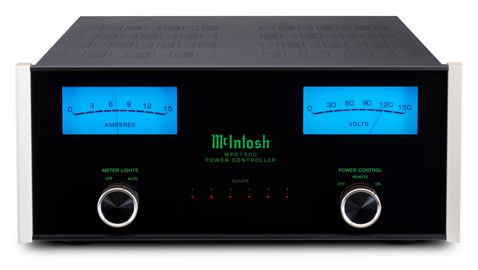

I am looking to acquire the McIntosh MPC1500 Power Line Conditioner. It has a large toroidal isolation transformer.
However, in this video this audiophile mentioned not to get a power line conditioner with a toroidal transformer because it will suck the power away from the amplifier and make it sound less open. Is this true with a toroidal transformer in a power line conditioner?

I didn't watch the video but that's nonsense! I'm guessing he didn't test it...
Of course there is efficiency loss in anything like this but as long as the output voltage holds-up while drawing the necessary power/current, that doesn't affect the amplifier or anything connected. i.e. If the amplifier is consuming 500W, the power conditioner might be consuming 50W internally and consumin 550W from the wall outlet.
...That's just a made-up number but 90% efficiency wouldn't be unreasonable at higher power output. At lower power it's probably less efficient and at no load (not powering anything) it will still consume some power and at that point it's zero-percent efficient.
It's not delivering less power to the amplifier (or whatever) unless it's stressed beyond it's specs/limits. But it's pulling extra power out of the wall.

His problem is he is starting from the false premise that the power conditioner can alter the sound at all.
It can't, for reasons that have been discussed and measured here frequently enough
That statement applies both positively and negatively - in that the sound can be neither improved nor impaired (assuming sufficient power is provided, and it basically works correctly), regardless of what transformer is in it.

You don't mention what model/brand of equipment you intend to power from this "conditioner" but if those units are of a relatively expensive nature I would expect that the power supplies in those units would be able to supply clean DC power to the operational circuits.
Toroidal transformers have two main properties that distinguish them from "E" core transformers. One is aspect ratio, toroidal transformers are "low profile" and allow more compact packaging for a given device and secondly, they exhibit higher "inrush" current than an "E" core transformer. This often requires a "mute" relay be included in the circuit of a power amplifier to avoid a "pop" when the unit is powered on.
The continuing mythology around AC power and its "cleanliness" ignores the fact that the DC powering your equipment is the result of the AC mains waveform being completely altered and filtered by the power supply built in to the equipment. Any supply using an "E" core or toroidal power transformer includes isolation as an intrinsic property of the transformer itself. Adding another transformer, supposedly wound in a 1:1 ratio, is completely unnecessary.
If the quote you mentioned is from the individual who has made the YouTube video, he is exposing his complete ignorance of electrical theory and is merely parroting something a salesman has fed him.
Inductors, in general, act to inhibit abrupt changes in current flow. So I think it's plausible that a beefy toroidal power conditioner could limit instantaneous current flow into a device plugged into it which has abrupt swings in current demand e.g. an amplifier. But, in theory, a good amplifier will have adequate capacitance on its power input so as to smooth out the power draw.

The current pulses going into the charging capacitors from a perfect AC power source are already ugly. The inductance/capacitance of the charging circuit will smooth out the square of the dimmer circuit, not much differece except power supplied. And the power reduction wont start till the dimmers at half power. (the peaks will still hit 170VDC)
The AC voltage would possibly sag more after any extra small transformer in the path , could impact max power but has nothing to do with it being toroidal. You get a voltage drop over the transformer impedance when under load .
Also a big traditional power amp draw current in pulses when the rectifier bridge tops of the power supply capacitors a quite ugly current.
The network impedance is not zero so the current will modulate the AC waveform and therefore other components on the same AC will have “worse AC” this effect is usually negligible. But a small enough isolation transformer could have relatively high impedance so this modulation is larger when using an isolation transformer.
Competently designed component's would not have a problem with this “bad AC” so in practice your DAC and preamp et all will not be affected by this .
Small is is relatively to the network short circuit impedance.
For performance a stiff low impedance good AC feed is all you need . I would rather have larger cross sections wires from the panel than a transformer in circuit. But it’s bit hypothetical as in practice it does not matter.
A product like this may offer protection wich one can have need for . Otherwise I would not bother with it .
The isolation aspect off this product could have some use cases . But again nothing to do with it’s design toroidal or other type of transformer .
The isolation is usually not necessary for a HiFi system. I would get this kind of product if there is a specific problem, there is no general problem to solve .
