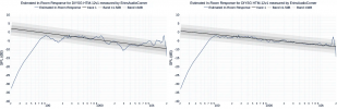

Why is SP and PIR important?
It helps to explain why, for example, Amir found the Wilson-Audio tunetot tonally not bad and with a little EQ even good.
Especially with the PIR, you can see that the LS does not show sudden or wide humps (when we ignore the ugly bass hump).
SP/PIR can help explain why even poorly designed speakers can still sound good in the listening room if they are tuned properly with SP or PIR in mind.
The better a loudspeaker is designed, the more the on-axis, listening window LW, SP and PIR curves converge:
For a loudspeaker that is nearly SOTA, the various curves are nearly parallel (ignore FR >15kHz) because the radiation is so uniform that the off-axis FRs hardly change. You can then focus on small details, for example, and use different XO designs to strongly influence the vertical radiation around the crossover frequency. Same LS with two different XO:
In both cases on-axis FR (black), LW (green), SP (blue) and PIR (orange) >700Hz are nearly parallel (DI is red).
However, since very few loudspeakers are SOTA, it is important to look at SP/PIR, or to consider these curves when designing and tuning a loudspeaker, and to value a smooth SP/PIR response more highly than a flat on-axis frequency response - at least that is what Stephen Entwistle probably wanted to say, and with which I strongly agree (I am more skeptical about other statements in the interview).
It is important that a uniform SP/PIR response is present regardless of wide or narrow directivity.
With a narrow directivity it is usually easier to achieve a uniform SP/PIR response and the curve shows a steeper drop.
Therefore horn loudspeakers can often be corrected quite well via EQ (if the directivity is even, which the DI shows us). Example without and with EQ:
Source
