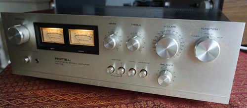

The same store also sells a 40 watt Rotel RA712 amplifier for £385.00:
Screenshot_2025-10-10_143925.jpgScreenshot_2025-10-10_143907.jpgScreenshot_2025-10-10_143914.jpg
View attachment 481865View attachment 481866View attachment 481867
both of these look great. Very much on my potential buy list. Thanks @DanielT much appreciated
