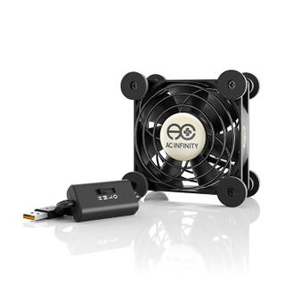

Ahhh that hot eh (sic)... Sigh* You don't want that. Heat is what makes a lot of electronics fail. The capacitors get baked and the transistors start making severe distortion and eventually the unit requires service for overheated and dissociated solder or a blown amp. Get at least 2 fans sucking air out of the amplifier and things will operate better and for much longer than with no fan in a tight confine.

I think your amp is overheating and the thermal sense circuitry is triggering the relay. I can't be 100% sure although under the circumstances and description is really seems like thermal protection. Use 2, 80mm fans but better is 2, 120mm fans or a blower squirrel cage type on top is good too because they are quieter and move more air. That is if you want to keep using the amp in a stand/case.

I'm currently trying to chose a pair of 120mm fans or a pair of cages with the lowest noise ratings, unfortunately the cages I've found so far have higher noise ratings than the fans, so I'll probably go with 2x120mm fans.

120mm fans are pretty quiet as well it is a very common size. There are 140mm fans too and the sound emitted is usually even lower than 120mm.

Nope... Use 2 fans... Both above the heatsink(s) in the amp. That way they can rotate slower, make less noise and move more air doing that. Yamaha is dragging it's feet on this one. That is if it got the first message you sent them. :D If you go 140mm use 2 again above the heatsink(s). The idea is to stop thermal protection from engaging and to extend the life of this beautiful amp. The cooler the amp runs the longer it lives.

You need fans that can give some air pressure while spinning relatively slow and therefore being quiet.
I recommend Artic P14 Max on 30~40% PWM having enough pressure, staying quiet and avoiding their 160 Hz fundamental going trough (from 50% PWM) and as they are cheap and should last long. Try to find a 5 peace's bulk pack.
You will need a controller and power source for it, don't know would the standard USB charger fit the need, it probably would as you won't run it on high spin and there for 12V rail.
