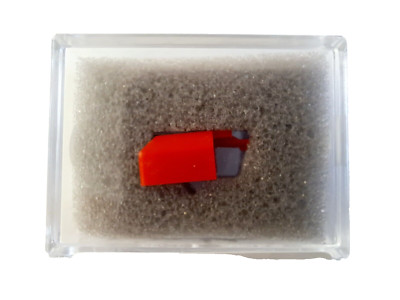

Or some "cheap record players" came with a ceramic cartridge which has higher output so they didn't need a preamp, but they need a high-impedance input so they aren't compatible with any "modern" inputs. They usually had a flip-over stylus like this picture. That's the clue. The replacement styluses were cheap and IIRC, in the 1970s you could get one from Radio Shack for $2.99 or something like that but it would probably hard to find one now. Ceramic and magnetic cartridges are not interchangeable.
* Vinyl is technically inferior to digital, but dome people like it and to them it can be "better".
P.S.
Another clue about a ceramic cartridge - I there's a little U-shaped rubber piece that the stylus shaft fits into, and it makes a loud sound through the speakers when you tap it with your finger, it's a ceramic cartridge.
