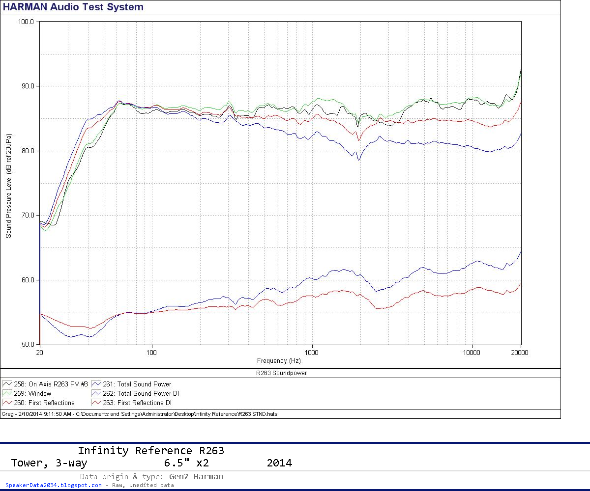

It is not shown in Harman spinorama dating back to 2014.
For comparison:
All Harman Spins for the lineup show a rise >18kHz or so, but the R162 & RC263 measurements Amir did didn’t show this.
If you look at the R263 SPIN:
It doesn’t even make sense how the LW is louder than the on-axis over pretty much the whole range, and the ER being louder than the on-axis up to ~300Hz.
here is a measurement done by HomeTheaterReview:
Also shows the 3kHz dip & 5kHz peak on-axis, but the “average” response looks normal (doesn’t have vertical info, but still).
