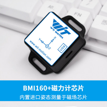

I am using two types of head tracking for check my result :
1. valve index vr headseat and a modified version CableGuardian which will send 6dof data into APO.
2. A little sensor which send 3dof data by wifi connection. (Can't find AliExpress version, sorry)
