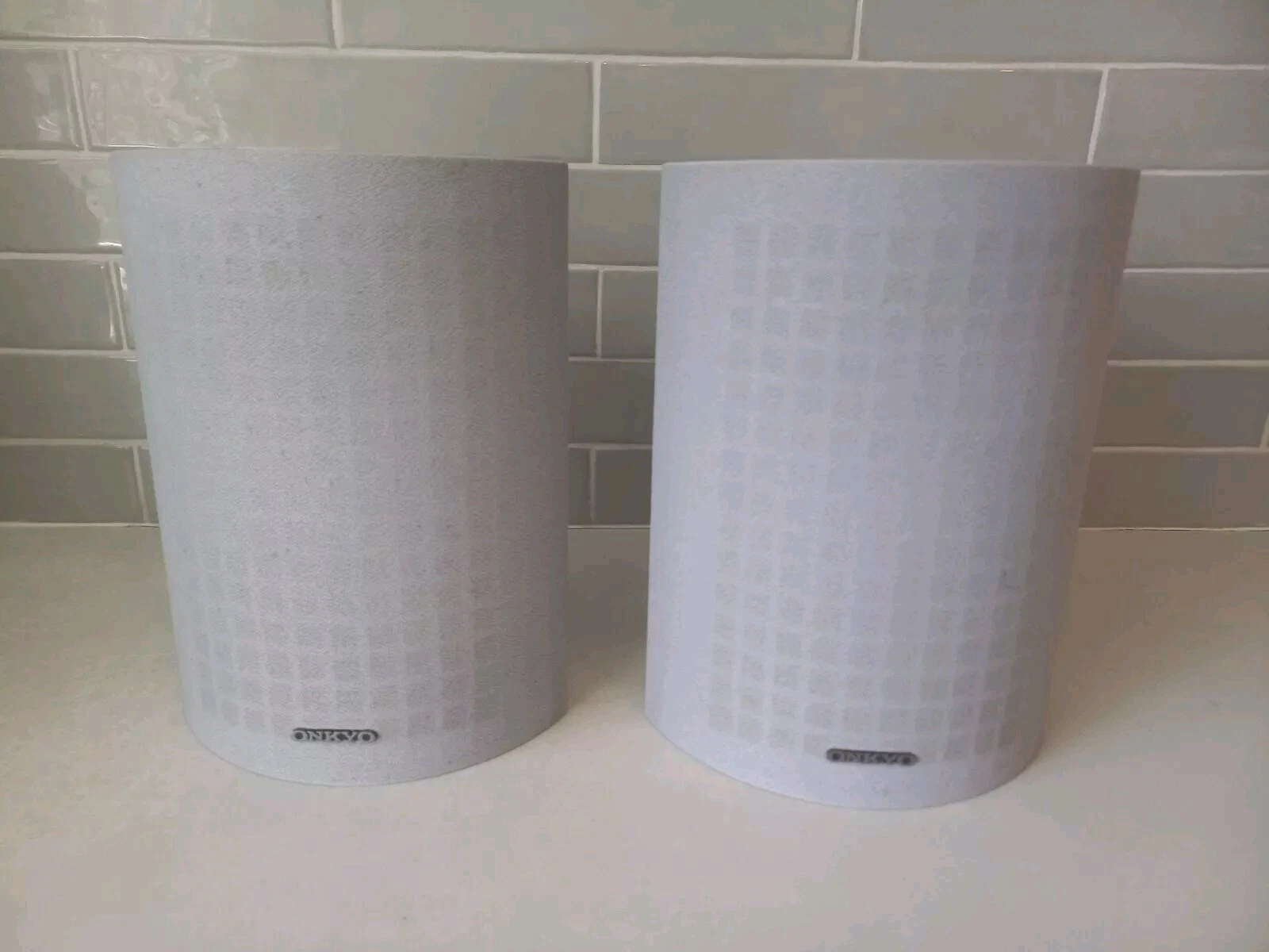

The speakers are very basic and came with the amplifier; they are ONKYO SKF-330F and the subwoofer is a JBL sub 138. My fear is buying good speakers and not having them sound good because the amplifier doesn't give any more than it should. That's why I was thinking about the amplified Edifier speakers, which would be cheaper than buying a new amplifier and speakers and leave the amplifier and these speakers only to watch a movie with 5.1 sound

Your current system is not too bad. It definitely could have been worse.
What Edifier speakers do you have in mind? Are you going to use them with this subwoofer?
Btw, your receiver will be able to handle bigger speakers.
Don't worry about this receiver at this point.
Also, what don't you like in your current system? What do you want to improve? Would you like to get more bass? What would be your upgrade budget?
