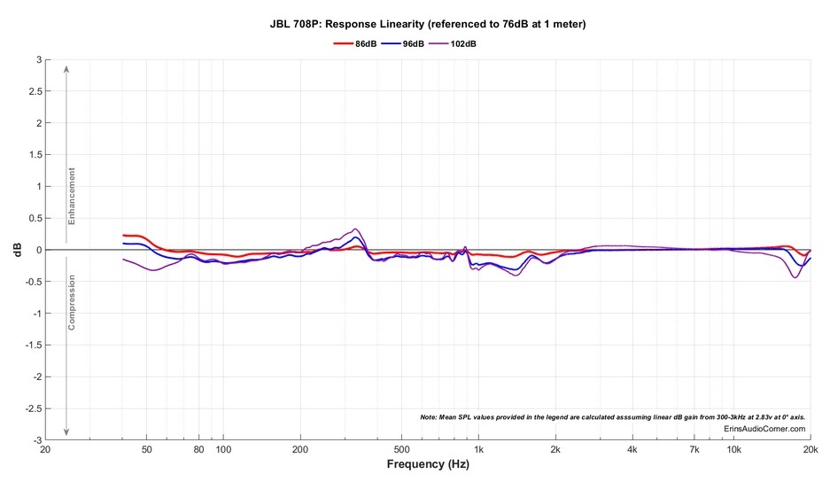

Professional monitor from JBL.
Speaker drivers and amplification are optimized to get the same response curve whatever is the SPL level.
It is a different design that has some additional qualities: low volume or high volume listening give you the same result.
