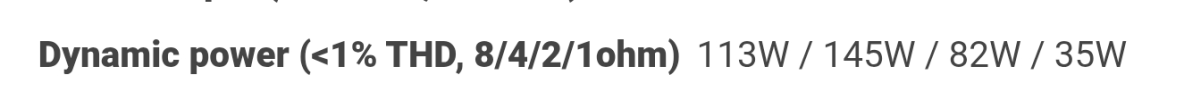

The WiiM Amp and Amp Pro are rated down to 2.67Ω
The Amp Ultra is rated down to 2Ω.
Compared to the M1, yeah.
Source
Indeed. The numbers don't lie.
But I can't say I ever felt the M1 as underpowered in any way. I think it drives my focals pretty well. At least to my ears.
