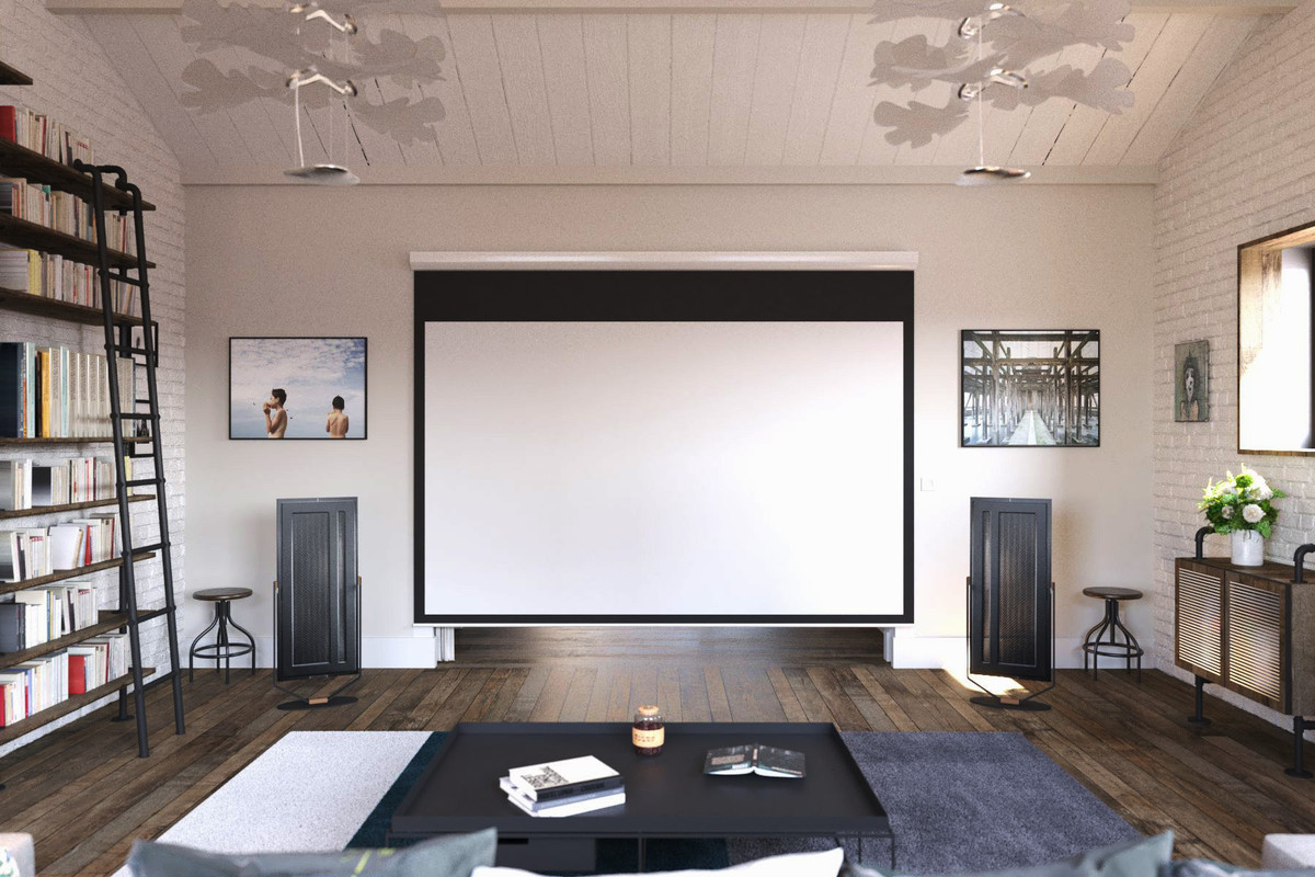

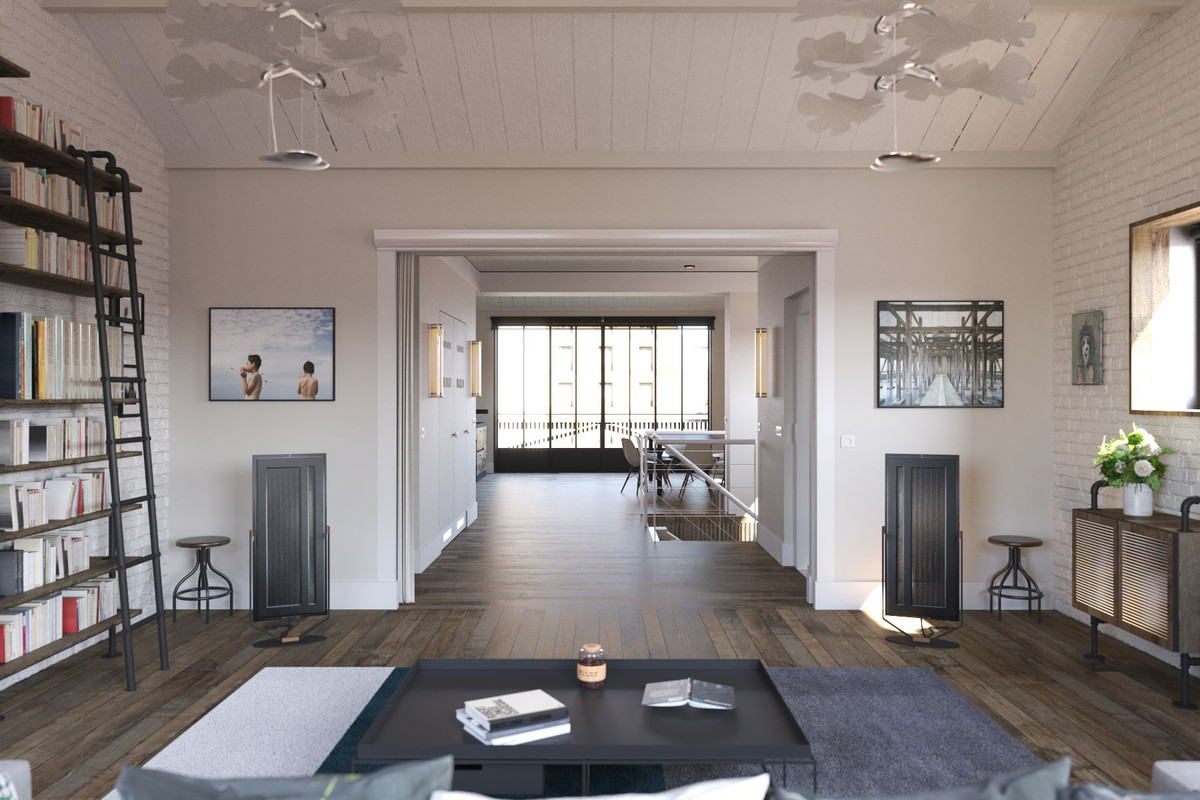

Seems you plan to barricade the emergency exit to the fridge and toilet with a screen. I would pull the screen further into the room. A meter should be sufficient to slip behind it to get a cold one.
Indeed :D:p
Don't worry, the screen isn't rigid. At worse you can crawl on the floor to the fridge!
More seriously, i didn't like the idea of a floating screen casing above your head when entering the room.

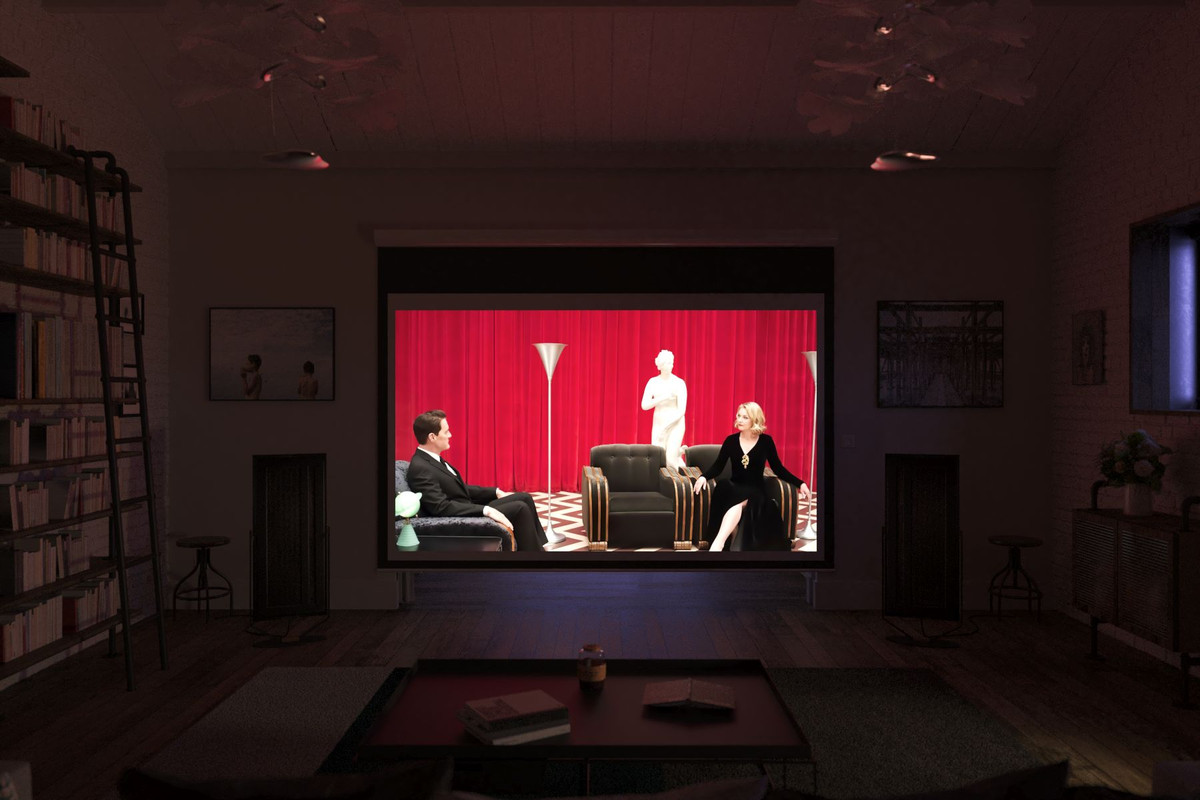

Update of the CG images with DP 107 modeled + night view

I've finally set up my all new system, from scratch, based on the DP 107 speakers and a Boxem A 5519/N2. Took me 3 years of waiting to move in this new builded home, but what a sonic bliss now! My 3D images were quite acurate btw :)
