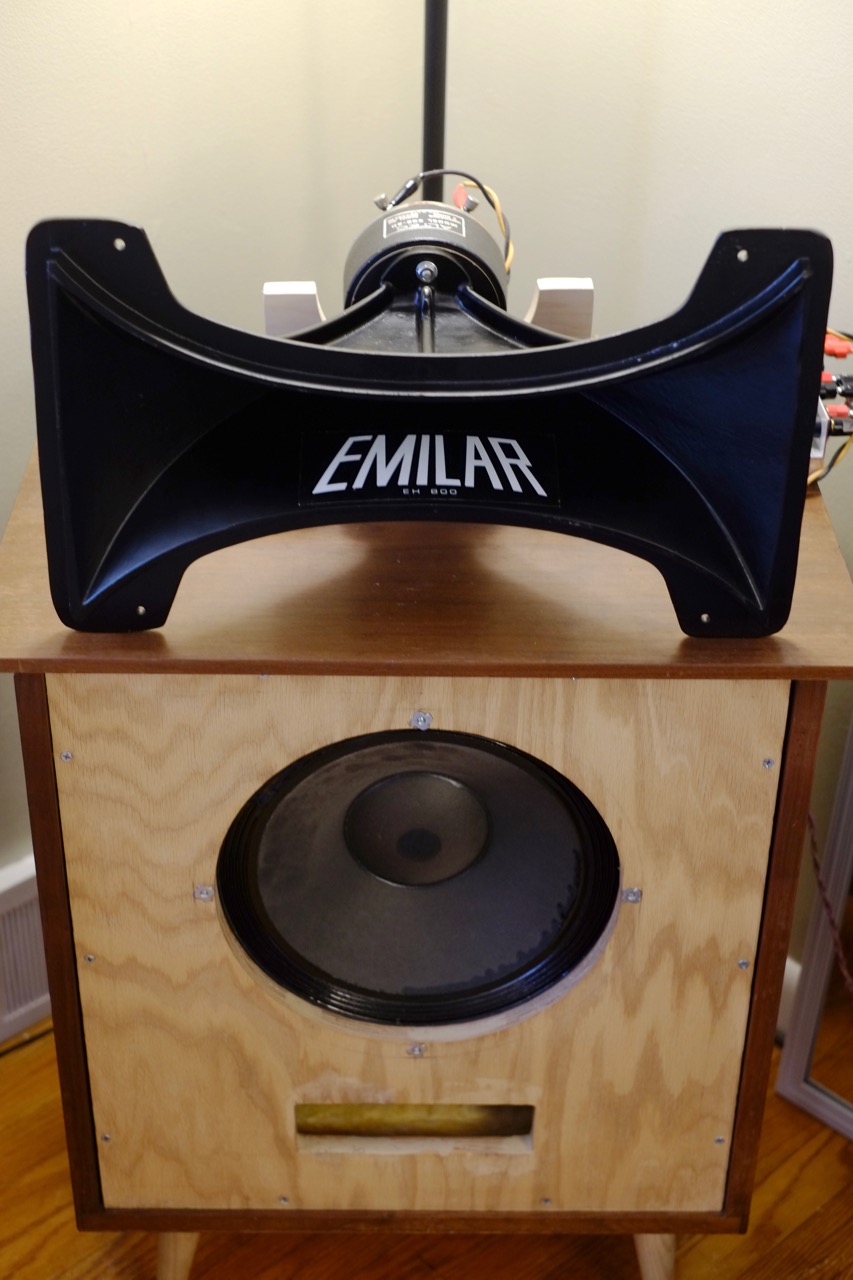

Things are a bit different these days, in the brave new world of DSP. EQ, digital time delay, and high order crossovers are all possible. JBL makes do with EQ and high order crossovers; if you haven't heard their premium horn speakers, like the K2 S9900, you should.Great for PA use. Gotta love that efficiency & directivity. As for home hi-fi use, I am not a fan of horns in general.

Agree. I have not heard what the best horn speakers can do.Things are a bit different these days, in the brave new world of DSP. EQ, digital time delay, and high order crossovers are all possible. JBL makes do with EQ and high order crossovers; if you haven't heard their premium horn speakers, like the K2 S9900, you should.
