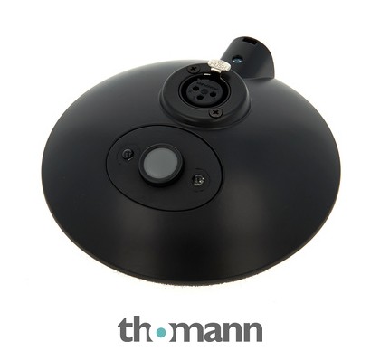

I stream online and also play with my friends, and I recently switched to a new condenser microphone that does not have a hardware mute button. I'm looking for something that allows me to temporarily mute myself, for example if I have to cough or clear my throat. It must support 48V for the mic.
I found this https://www.thomann.de/de/rolls_ms_111.htm
But man is it expensive. Any alternatives?
