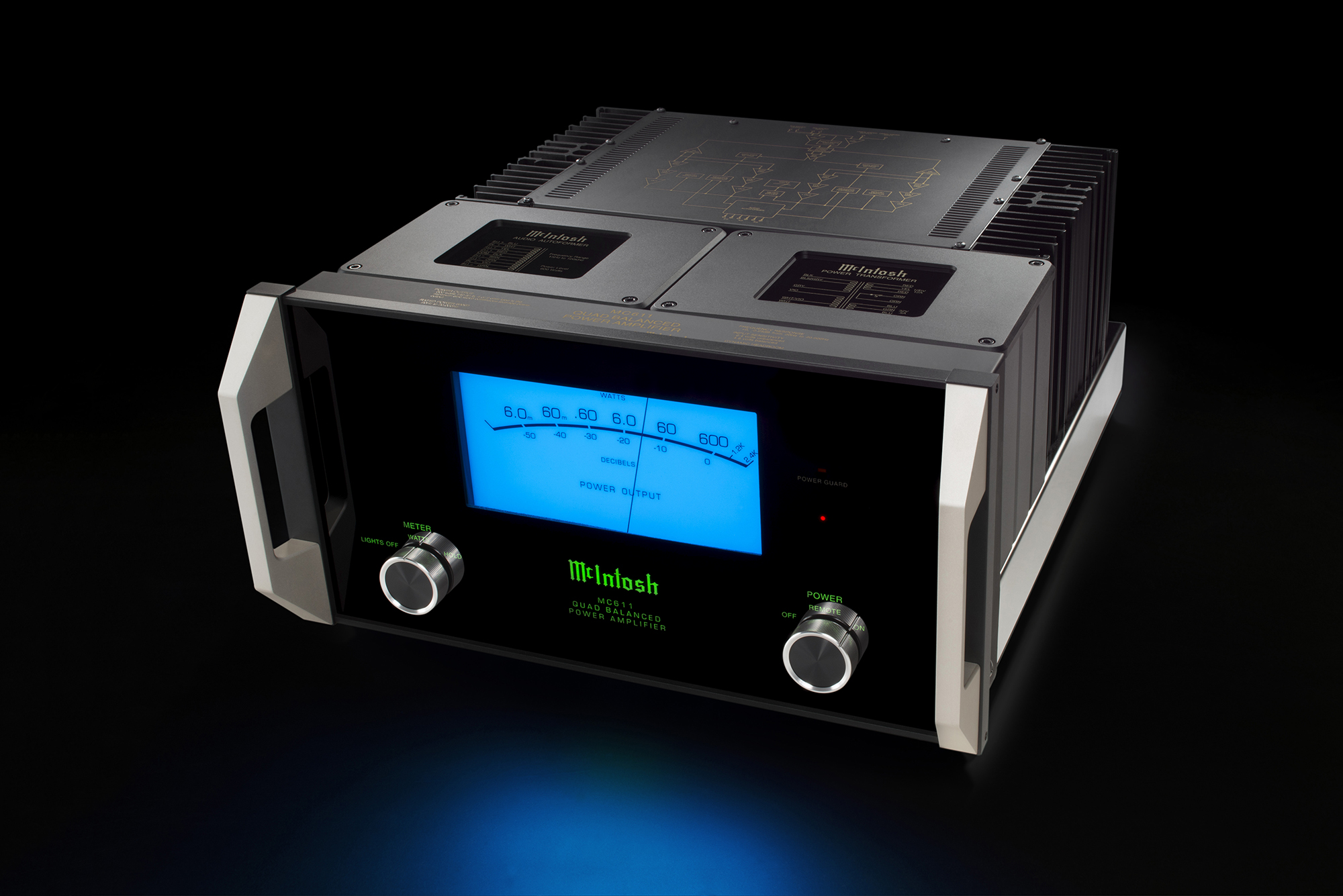

Excellent. So which Mcintosh is this? Only some of them have output transformers.
I don't always agree with Paul McGowan, but he has an interesting take on McIntosh transformers.
It looks like it is dominated by THD.
This one:
If you mean the famous Mc autoformers, yes, this one has them, hence the consistent power delivery.
