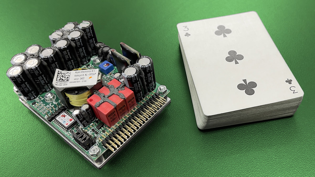

Here is a sneak peek at Buckeye's 2-channel NCx500. He sent me a unit for testing as I already had the amp modules in stock. So here is a quick look at using the SMPS1200A700 to drive one channel individually and then both channels together (test is 4 ohm load with 1 kHz signal). The unit is set for HIGH gain....
Sorry for the similar colors, but matters less as you can see the results at lower power are very comparable. As you would expect, the medium blue line is the distortion with both channels driven and the other is only one channel. FYI, the free version of REW allows for 2 outputs, but only one input. I did test measure the other channel and they track well. For simplicity, am only displaying one.
As predicted earlier, 1% THD occurs around 600 watts and 700 watts respectively. I plan to post a more comprehensive set of measurements in a new thread.
What it more important than the 1% THD mark is the 0.002% THD mark which is identical,100 watts less (or more,depends from where you see it).
