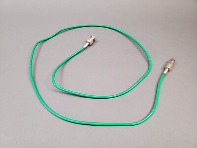

so something like this? :
Converter
Wire
Btw is this advisable i mean skipping the dac totally and just linking to the kh750 directly from the digital output?
Well, if you trust them. The former converter offers no specs. The adapter cable is clearly used and kinked while there are new alternatives at the bottom of the same page.

You need a Toslink to Coax converter, plus an RCA to BNC cable.
If your motherboard has a SPDIF header, then you can skip the converter.
