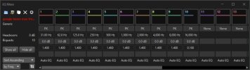

I would like to see if I am doing this right in REW; I followed this video here for setting up most of REW:
And then beyond that, my question lies in how I am trying to fit in the correction to the EQ I have available. It's a 10 band octave type, where I can only change the gain on these ten frequencies (31, 62, 125, 250, 500, 1000, 2000, 4000, 8000, 16000).

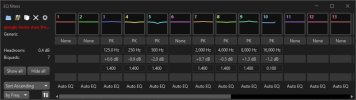

I first get everything setup as shown in the first image, then I go to EQ filters and plug in those specific frequencies (see second image), then click "Optimise gains" (if I click "Match response to target" my frequencies will get wiped out), and then I'm only left with a few remaining filters (see third image.) Am I going about this correctly? Something is telling me I should instead be picking a different EQ model, like the 'Configurable PEQ' and then setting that up such that it only applies filters on the octaves, but maybe this is a different way of doing the same thing. Thanks in advance.

REW has the ability to set parametric EQ's, meaning that the frequency, Q, and gains can all be set. Your EQ has fixed frequencies and adjustable gain. If the Q is fixed, which it probably is, then you have a graphic EQ.
To set a graphic EQ, overlay the target curve on top of the measurement. Make sure your measurement is heavily smoothed, I suggest 1/3 smoothing. Then read the deviation of the measurement from the target curve at at 31, 62, 125, etc. Input those values into your EQ.
Warning: above 500Hz or so, try to make sure that the left and right values are the same. Any deviation between L/R at those frequencies is likely due to measurement artefact rather than discrepancy between L/R speaker.
