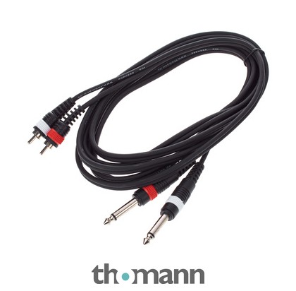

No interface only Topping D30 dac. I am trying to calibrate the system using an android spl meter. The sub starts to rattle around 85db. I am not sure if the spl meter software is accurate but the sound doesn't seem to be extremely loud. Is it normal or should i use %50 windows volume
This approach won't work. The SPL meter will not have flat response over frequency.
You could get this as a basic measurement setup:
Sub rattling could be the frequency is below its tuning frequency and the sub is running out of excursion.
