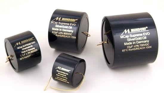

Crossovers: L, C, and R. As long as the proper values are in place in the crossover, all will be well. The signal cannot tell what dielectric is between the capacitor's plates, but it can "tell" the C and R of the capacitor. ;)
$100 won't get you too far in the boutique crossover component marketplace.
Yes, of course, this is an extreme example. But leaf through the products @ Madisound (in the US) sorted by price...
