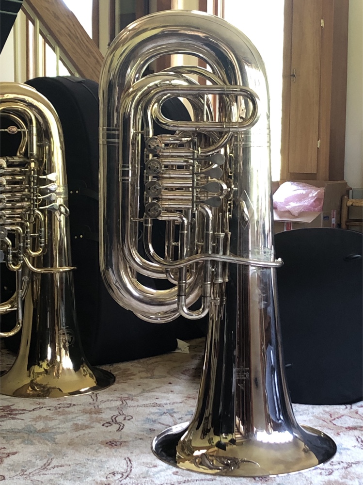

Rick "who plays an instrument for which music has been composed down to about 32 Hz" Denney
