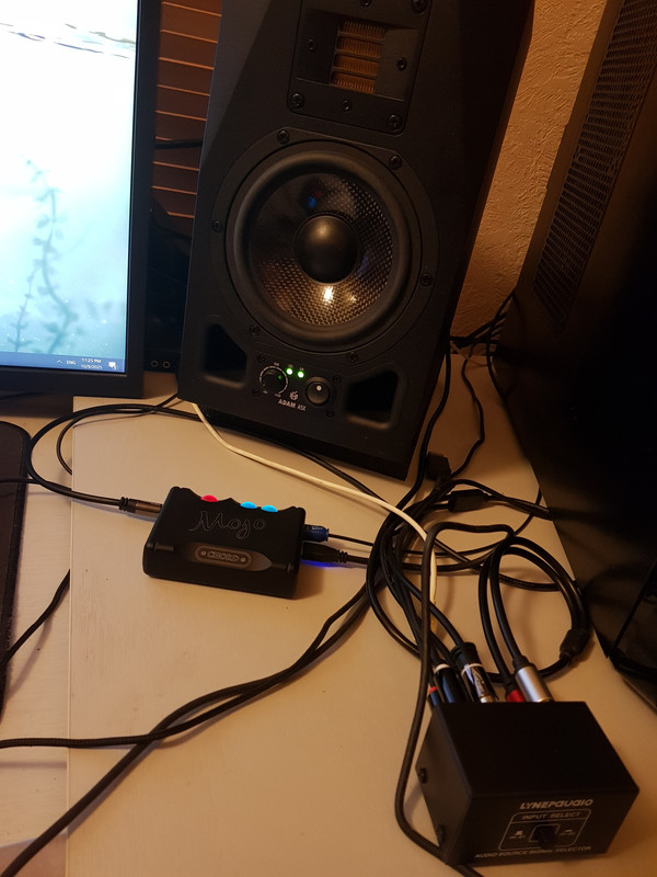

Apple USB-C Dongle connected to a PC; and PC optical out to Chord Mojo 1. Both sources are connected to an RCA switcher which is wired to my active studio monitor speakers Adam A5X. https://i.postimg.cc/vmc1nhj6/mojo.jpg
Procedure:
My test was to be done in the following way. There are N trials, each trial consisting of the same song section played twice. The experimenter chooses if it is played from different sources (e.g., dongle then Mojo) or on the same source (eg., dongle twice). Volume is set to zero in the beginning of each song, the participant is free to adjust it. The participant ranks the first song as 10, second song as 11, 10 or 9 =better, same, worse. The experimenter adds up all the scores for both sources, divides by the number of trials and we have a result.
Unfortunately I could not convince my partner that the needs of science were greater than hers, so I did the "blind test" myself - thus omitting the hard "any trial could contain two instances of the same source" case.
Yesterday, I've attached all the audio cables to an RCA switch box, and this morning I realized that I could not remember which switch position corresponded to which source - hence my decision to run the test. Apart from the physical button, I've used a script to switch between the optical out to Mojo and the Apple dongle sources in Foobar. When I clicked it, it switched between the two sources without it telling me which of them was active (there was merely no sound if it did not correspond to the RCA switcher position).

Every song started with the volume dial on the speakers set to 0 or near 0. I've adjusted loudness for every song to where it felt good - this was different for every song and every trial. Volume settings were very close and I could not guess the source from fumbling with the volume dial.

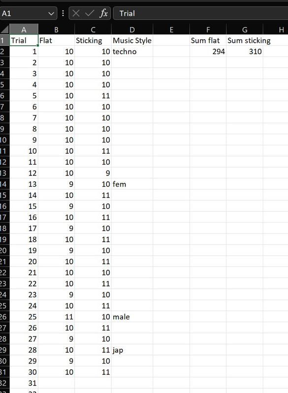

Out of 30 trials, Mojo won on 18 trials. 10 trials were a draw. Apple won 2 trials.
  • Chi-square statistic: 12.8
  • p-value: 0.00166
  • The p-value (0.00166) is much smaller than the typical significance level of 0.05.
  • This means I reject the null hypothesis and conclude that there is a statistically significant difference in the preference between Mojo and Apple Dongle.
Here are the scores for 30 trials (flat = flat RCA switch position, this turned out to correspond to the Apple dongle; Sticking = the switch was sticking out, this turned out to be Mojo): https://i.postimg.cc/XY65mqLy/Mojo-experiment.jpg

1).I always knew that each trial had 2 different sources, this made things easier - this is a biggie, and I still hope to convince my partner to donate 30 minutes of her life to redo this.
2).Although the volume dial settings were very similar for both sources (about the 1st mark on the drawn scale- depending on the song), and I did not look at this scale when setting volume, I may have developed a subconscious feel for which source corresponded to which volume setting. Asking my partner to go louder or quieter would also mitigate this. I don't want to rely on precise volume matching as changing volume for each song and genre is a natural way to listen to music and I tend to doubt the precision of those measurements.

The flat or the sticking out position of the RCA switcher button was the ultimate tell ;) I knew every single time that I was switching to a different source, I just did not know which one. I similarly did not know which volume dial position corresponded to which source. Moreover, volume dial position was harder to judge because:
1). I did not return the volume dial to its absolute zero for every song to confuse my muscle memory. Different songs required different volume which confused my muscle memory more.
2) The dial travel from zero to listening volume was about 5mm, the zero volume has play of another 2mm. These small adjustments with their small differences were difficult to differentiate by touch. Both sources played at my comfortable level at around 5mm mark.
Basically, I would still defend my method as good enough for cases where one cannot use microphone or multimeter. Asking another person to go "louder please! louder, louder, stop!" would further decouple the participant. But, even without this extra step, if it is not known which exact source corresponds to which physical volume dial setting, then all you learn is that you're playing a different source - as was the case here.

"Playback/Device/Headphones (USB-C to 3.5mm Headphone Jack Adapter) [exclusive]",
//"Playback/Device/Primary Sound Driver",
var currentDeviceIndex = 0;
// A label to display and click
function on_paint(gr) {
gr.FillSolidRect(0, 0, this.width, this.height, 0); // Black background
gr.DrawString(
"Switch Device",
gdi.Font("Arial", 14),
0xFFFFFFFF,
10,
10,
this.width,
this.height
// A function to handle the click and change the device
function on_mouse_lbtn_up(x, y) {
currentDeviceIndex = (currentDeviceIndex + 1) % devices.length;
var deviceName = devices[currentDeviceIndex];
fb.RunMainMenuCommand(deviceName);
// Optional: Show a popup to confirm the device change
//fb.ShowPopupMessage("Switched to: " + deviceName.split("/").pop(), "Device Switch");
Results:
  • p-value: 0.00166
