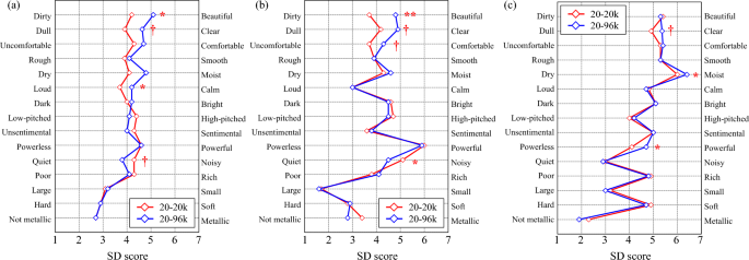

I have been trying to find independent replication attempts for the "hypersonic effect" and there really isn't much (i even resorted to asking grok due to being out of free messages for claude and chatGPT).
We have this short paper which may have found something but nothing particularly convincing:
So far i have only found 2 decent quality independent replication attempts (with regard to brain activity) and seems like neither bothered to minimize the impact of IMD by playing the ultrasonics from a different speaker:
I did read something about it taking 150 seconds for the difference to fully emerge.
Typically the best approach for finding differences when testing blind is by rapidly switching between versions and this can allow you to pick up on tiny differences between versions but when i tried that method with regard to ultrasonics i had a very hard time hearing any difference (at least after controlling for IMD by using a separate speaker for the ultrasonics). So i guess i have to try a longer test track next but first i need to get an amplifier that extends to at east 40Khz.
I did test a longer track many years ago (24-192 vs 24-48) and then i experienced something consistent with the hypersonic effect but that may have been a coincidence result since i didn't use proper randomization and the 24-192 version ended up playing last for the 9/10 guesses i got right. Said track also seemed to mainly have noise above 20Khz but perhaps noise works just as well as actual musical content for inducing a hypersonic effect?
