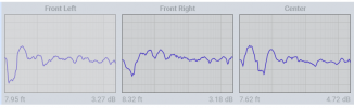

Hey,
I'm trying to track down the root cause to some shrillness in the system. I think it relates to the peaks/valleys I'm seeing at higher frequencies on my LCR channels. For now, I have EQ'd them down, but if possible, I prefer to leave most the high range all natural. (Don't judge my bass curves, my subs fix all of them)
I have first reflection on side walls treated, back wall is pretty far back, so i'm not sure that could add to the SPL of the higher frequencies. Is it possible these are caused by ceiling reflection points?
I've attached my Audyssey measurements (with the calibrated mic).
L/R Speaker
C Speaker
You have KEF speakers? Just a guess based on the charts.
This is mistaken thinking. Natural is what sounds good or subjectively neutral. EQ does nothing to a speaker that isn't already happening electrically in the crossover.
Anyway, your fix, which is using broad EQ, is right. Your speakers are fairly flat on and off axis, so are likely to sound bright. By adding broadband treatment, you've effectively EQed the reflected sound and increased the relative strength of direct sound. So the characteristics of the listening window will be more prominent.
I don't think you should use Audyssey for system assessments. REW is the way to go. Hard to say what those charts you posted are actually showing.
Welcome to ASR!
What's interesting is all 3 speakers show the same 2 peaks and a dip in the upper treble. This is pretty unusual to see, and suggests maybe you are having some nasty reflections from something.
I think with REW you can check the timing of reflections and that should give you an idea of how far the reflections might be coming from, which should help you narrow down the cause.
Thanks All!
I had a bunch of REW measurements last night, but I apparently did not save them. I just ordered a UMIK-1 as i'm getting annoyed carrying my Focusrite around for my ECM8000. I'll redo the measurements with the UMIK-1 when it gets here tomorrow.
Yes, I do have KEF R7/R2C.
I hadn't heard treatments described as effectively EQ'ing the reflections, but that makes sense. In my perfect world I just go to Auddyssey to set a target curve and forget about it. (Obviously doesn't work as well as I'd hope, I bypass it entirely for sub management) I'm currently using the dolby atmos music target curve as I listen to a bunch of atmos content and these are dropped in to a home theater. Interestingly I have KEF architectural for my surrounds/atmos and they almost match the atmos curve perfectly, so I don't need to EQ after about 1500hz on them.
This is what i'm concerned about. I haven't used the reflections capabilities in REW yet, but i'll look up a tutorial to see if I can't figure out whats going on.
