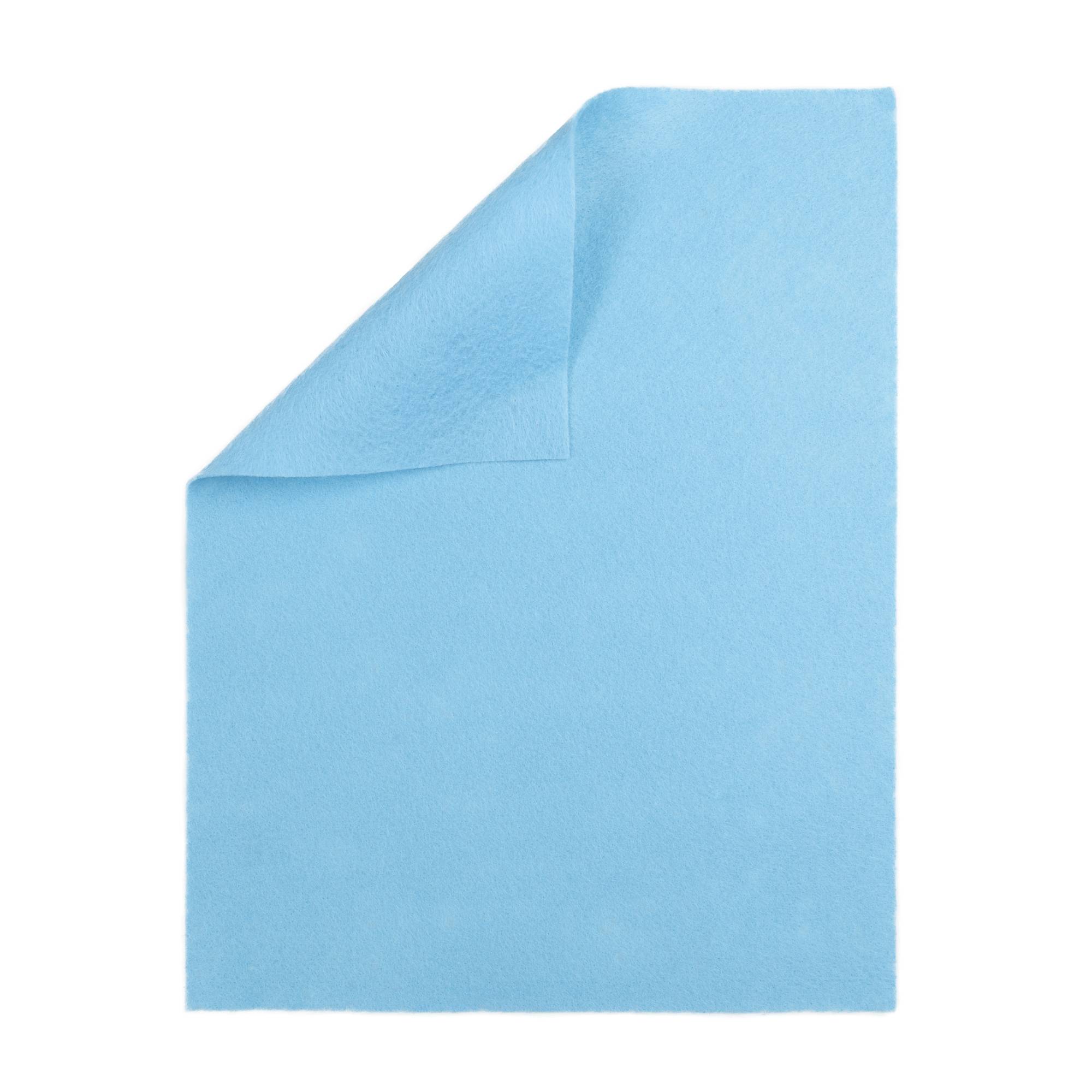

What felt did you use for the fuzzor? does it matter? I have access to sticky back felt from a craft store, which is maybe 1mm thick, and is made out of polyester:
would that do?
