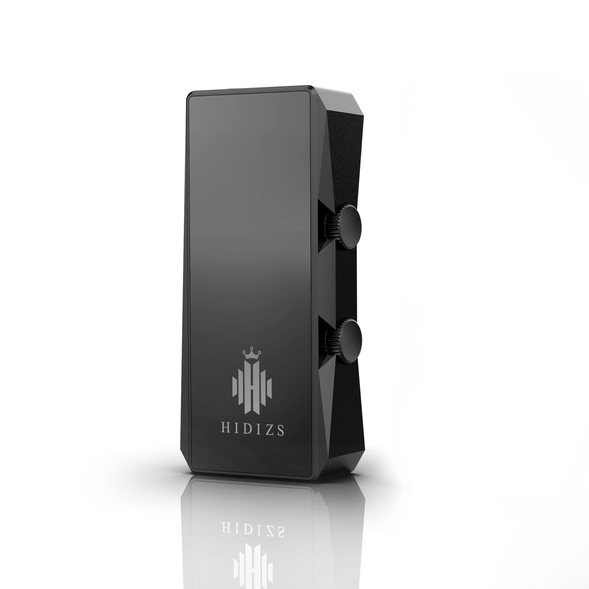

For the record: the S9 Pro will be soon replaced by the S9 Pro Plus.
Hidizs proposed to send me a sample for review, that will be published later (I mean: later ) this month.
