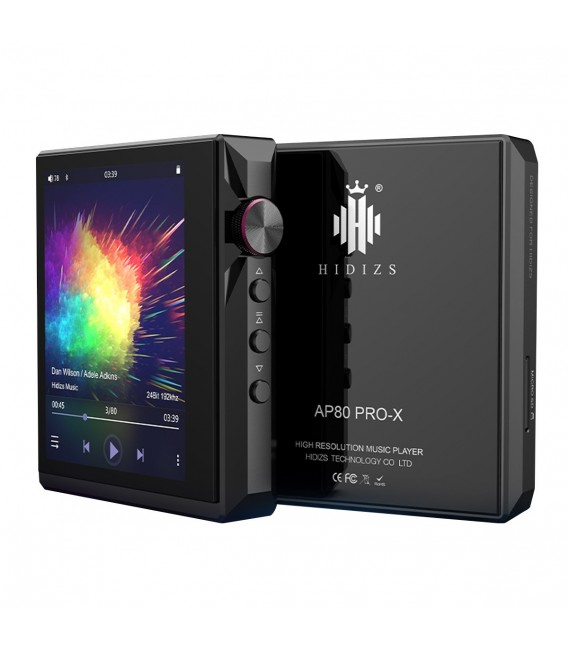

Pic;
This is using dual ESS ES9219C DAC's and an Ingenic X1600E SoC.
JSmith
Amigos, keep in mind :
Differences between Hidizs AP80 Pro and Pro-X
The AP80 Pro-X is the update of the AP80 Pro. The main tech difference between the two is the all-in-on DAC-amp chip. The AP80 deploys two ESS ES9218P chips (introduced in late 2016), and the AP80 Pro-X features two ESS ES9219C chips (introduced in late 2019).
Both all-in-one DAC/amp chips have effectively the same specs, but the ES2919C features hardware-level MQA decoding and it has a lower battery consumption at standby/no load.
Yeah, but this Pro Max is the newest one released just before Xmas, upgraded from the Ingenic X1000 to the Ingenic X1600E SoC.
You're right thanks for the info, just read this :
The major update of the MAX edition over the previous models is the support for 2.4GHz WiFi streaming for Tidal and Qobuz, as well as DLNA & AirPlay, but it is not the only one.
The AP80 PRO MAX maxes out over its predecessors by using a new Ingenic X1600E SoC for smoother performance. Additionally it now has a bigger 2.95’ touch screen, a 4.4mm balanced headphone output and a larger capacity battery (1300mAh vs 800mAh).
The DAC architecture is the same (dual ES9219C chips) but the AP80 PRO MAX has higher Dynamic Range and lower S/N ratio ratings. All the other features remain pretty much the same with some incremental improvements.
The AP80 PRO MAX supports bi-directional Bluetooth 5.1, micro SD card expansion up to 1TB, two way USB DAC function and HiBy link among other functions.
