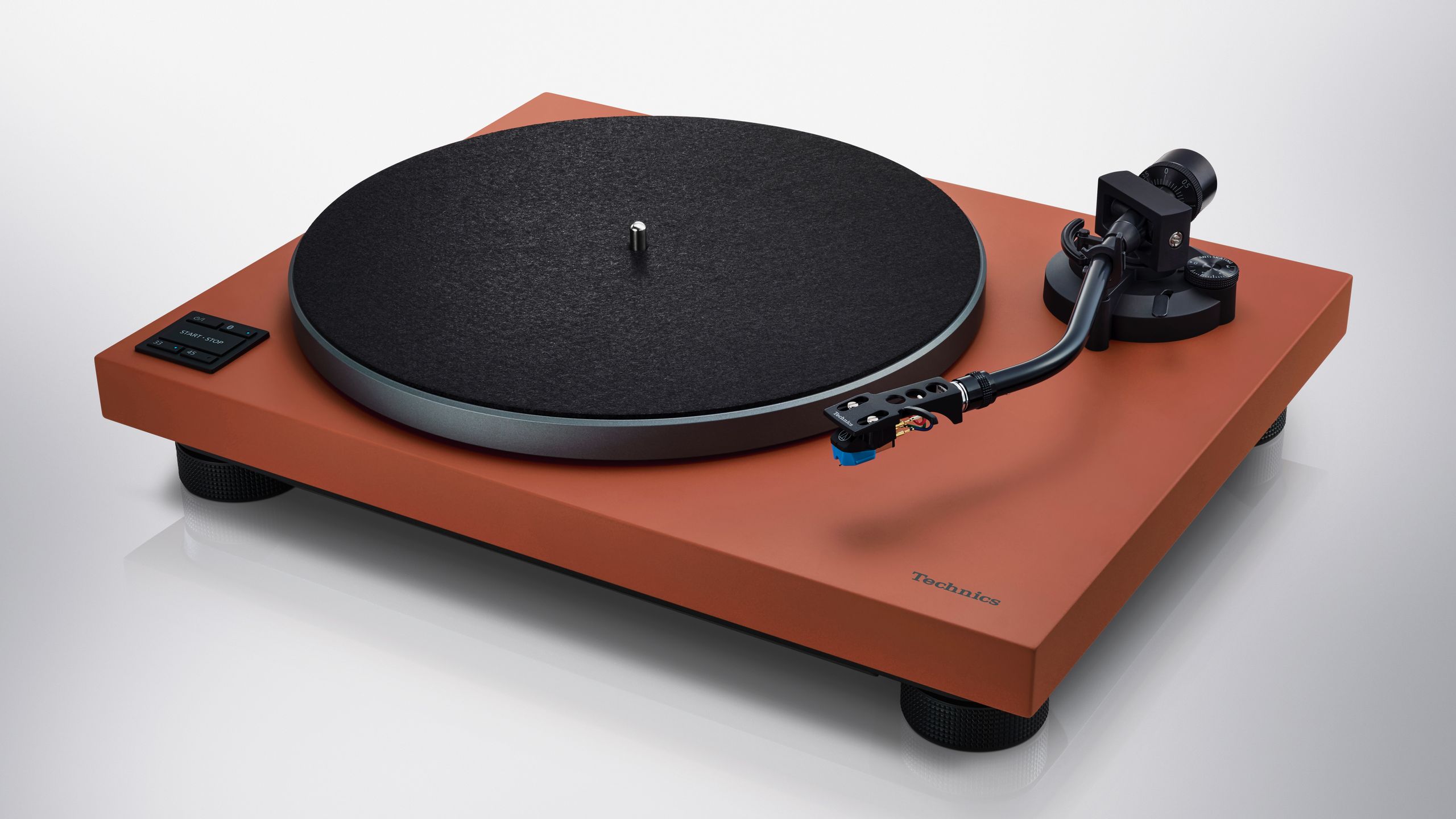

If you don’t like the disco look maybe this is more for you, probably better than any belt drive (rega) in same price range
This one, actually, looks really nice. I was about to buy SL-1500C-K, but now I'm really interested in SL-40CBT. Any comments on its performance?
Have to chime in here - the SL-1500C at, still - under 1400.- is in a different class all together, than the SL-40CBT at about 900.-
The underlying engineering speaks for itself, and if I were to get something to hold on for a while, the SL-1500C would be my choice. In off white... :)
