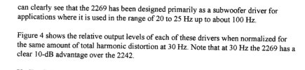

Well, months passed and i am still enjoying my DIY 4645. But the 2269 is luring me to buy it. It would be a significant upgrade- More than twice the xmax, higher sensitivity(actually is, below 80hz where we use it) and higher power handling, and considerably lower distortion.
Most of the LFE content is below 80hz, where the 2269H has a clear advantage, it equals 2242 at 80hz, and below that it increases rapidly, and at 30hz there is almost a 10db higher output (at the same input power) So technically 2269 is more sensitive than 2242, and should be a big big jump.

.10 dB more output at 30 Hz? From what I see, it’s closer to a bit over 5 dB , which is already significant. I guess that for an LFE channel, the 2269H will clearly perform better. It’s a true subwoofer, whereas the 2242H isn’t. I was about to pull the trigger, but since we’re moving back to France, it’s not the best moment to do it. The 4645C cabinet works fine with the 2269H; it has already been done successfully.
.10 dB more output at 30 Hz? From what I see, it’s closer to a bit over 5 dB , which is already significant. I guess that for an LFE channel, the 2269H will clearly perform better. It’s a true subwoofer, whereas the 2242H isn’t. I was about to pull the trigger, but since we’re moving back to France, it’s not the best moment to do it. The 4645C cabinet works fine with the 2269H; it has already been done successfully.View attachment 493131
6db higher output with around 15db less harmonic distortion, if the distortion is equalled then the difference is almost 10db.
