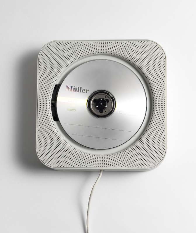

Muji did a really good job IMO, probably the inspiration for the above:
