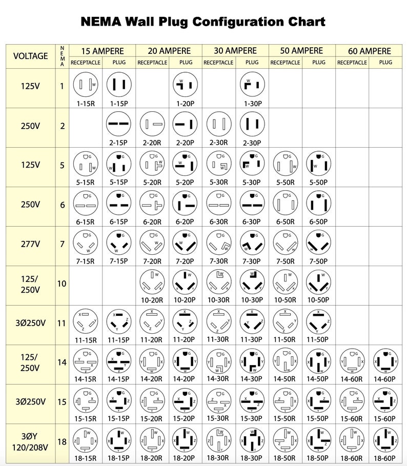

Every wall socket (except for the GFCI ones [which are 15 AMP]) in my house (which was built in 1968) in Charleston, SC, USA are 20 AMP outlets (as are the breakers).
And when I had the new breaker box and new wiring done, I went with the same.
The maximum power that can be safely supplied by a standard electrical outlet in the United States is typically 15 amps, or about 1,800 watts.
However, it's important to note that this can vary depending on the type of outlet and the electrical code used in the building.
If we assume that circuit breaker limitations are not a consideration, it's still important to understand the capacity of an American wall socket. Here's some information to help you understand how many watts an American wall socket can handle:
  1. Circuit Capacity: The capacity of a circuit determines how much power it can handle. In the United States, most circuits are designed to handle 15 or 20 amps. A 15-amp circuit can handle a maximum load of about 1,800 watts, while a 20-amp circuit can handle a maximum load of about 2,400 watts.
  2. IMPORTANT!:-----Outlet Capacity: The capacity of an individual outlet is typically the same as the circuit it is connected to. ----So, a standard American wall socket can handle a maximum load of about 1,800 watts on a 15-amp circuit or -----2,400 watts on a 20-amp circuit.
  3. MORE IMPORTANT!!!:-----Safety Considerations: It's important to note that even if an outlet can handle a certain wattage, it's always recommended to avoid overloading the circuit. -----Overloading an outlet can lead to overheating, damaged wiring, and increased risk of fire. -----It's best to distribute the load among multiple outlets or consider using dedicated circuits for high-power appliances.
    May include: A black and white chart showing different electrical outlet and plug configurations. The chart is labeled with voltage, amperage, and NEMA number. The chart shows different types of outlets and plugs, including 15-ampere, 20-ampere, 30-ampere, 50-ampere, and 60-ampere. The chart also shows the different types of plugs that are compatible with each type of outlet.
