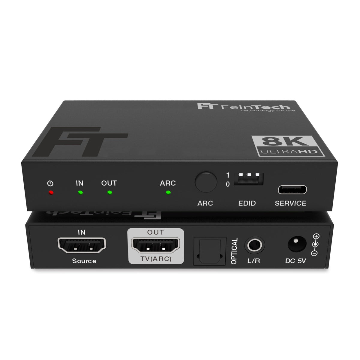

I use this audio extractor between my AppleTV 4K and my Samsung TV:
Previously I had the AppleTV connected to the Samsung TV and audio extraction was done in my cheap TV.
Feintech audio extraction is higher quality, sound is cleared and cleaner, and I didn’t loose eARC & CEC which help me to turn on/off both at the same time.
