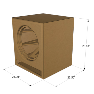

What do you know!? I found a MBM (Mid Bass Module) tuned to exactly 27Hz on GSGs website.

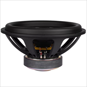

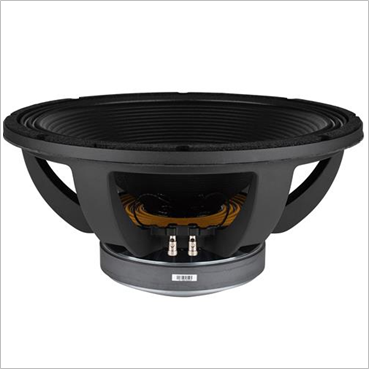

My question would be what driver would you recommend for this box? I’m deciding between
Ultimax II.
Lavoce

Clearly, the AI has little idea what it is doing. The UM18 isn't exactly made for a reflex enclosure. It's much happier in a closed box. At 6 cuft and 27Hz tuning, you'll get a massive bump in the response at 40 Hz. Probably not what you want!
Just use some proper tooling to simulate the box. WinISD will do the trick just fine
You'll need way more volume and way lower tuning to properly integrate the Dayton woofer, like 14 cuft @18Hz or so:
But a closed box is a much better fit.

Can you help model me a cabinet for the
LaVoce SAF184.03 18" Professional Subwoofer

Are you open to using electronic EQ? That driver in a sealed box will end up giving you a 45-50Hz rolloff, but you absolutely can EQ it flat to under 30Hz. The Linkwitz Transform is your (potential) friend.
Thanks, yes! I was already planning on hooking the two subs to a mini dsp and eq them.
I just finished building 2 GSG 18" "Full Monty" subs with the LaVoce drivers.
A few thoughts.
GSG kits are great. Very well braced, precision cut, good instructions.
I am running my "Full Marty's" sealed and prefer them that way for music. If I was going to do it over again I would start out with large sealed and well braced enclosures with a Qtc 0.707. Old school and "too big" according to some but easy, reliable, and great time domain performance which is the downfall of many "modern" subs.... DSP makes advertised specs look good at the expense of group delay / transient response.
LaVoce drivers are great, much higher mid-bass output which can be "shaved off" if needed. Due to lower X-max and higher efficiency they have less distortion but still plenty of LF extension in the right enclosure, probably more than the Daytons at reasonable distortion levels. You may find that big subs not only fill in the LF but they also can put out high SPL ~100 Hz which is where the majority of the energy in most music lies and many main speakers start to distort or compress more than you might think if you are trying to play loud. For dedicated sealed subs there are probably better drivers but I would stick with the "pro-audio" drivers.

From GSG web site FAQ:
How "low" will a driver go?
From time to time we get asked about drivers and cabinets. Frequently, folks see a particular driver specification (such as the driver free-air resonance (Fs), a claim by the manufacturer that the driver is good for a particular range, such as 20-150Hz, or that a driver has a particular -6dB point such as 28Hz) and are led to believe that these numbers determine how low a subwoofer can play in a particular enclosure. This is NOT THE CASE!
When a driver is placed in a cabinet, the two form a *system*. As such, not knowing anything about the cabinet that a driver will be placed in tells us nothing about how the driver is capable of performing.
For the first example, we will use a Dayton UM-18 driver, which is a long-throw, low efficiency (88dB/1w1m), subwoofer with a ton of excursion capability (usable excursion of over 30 mm). It has a free-air resonance (Fs) of 21 Hz. For the second example, we will use a LaVoce SAF184.03 driver, which is a hybrid driver that has medium-high efficiency (95 dB/1w1m) and medium-high excursion capability (usable excursion of approximately 19 mm). It has a free-air resonance (Fs) of 29 Hz.
So which driver “will play lower”, the 21 Hz driver or the 29 Hz driver?
It turns out that when these drivers are placed in a Mini-Marty subwoofer cabinet (which is approximately 7.5 cubic feet of internal volume and tuned to 18Hz), both drivers will have the same low end extension! The picture shows output at a nominal 1,100 watts of power, just for comparison. (Note that frequencies below approximately 16 Hz will be filtered out by the protective high pass.)
At 1,100 watts of power, neither driver exceeds its excursion capability. The LaVoce, however, provides quite a bit more output in the mid-bass region (60-120 Hz). When EQ’d to have the same response as the Dayton, the LaVoce will require quite a bit less power to produce the same amount of mid-bass output. This in turn gives it a subjectively harder-hitting mid-bass.
In summation, be careful when reading about driver parameters, manufacturers’ claims, or folks on the internet stating “how low a driver will go”. In order to know for sure, one has to model it up using the Thiele/Small parameters and for the most part, the enclosure itself is the dominating factor in factor in determining how low a driver will play. Of course, how much usable excursion a driver has is important when selecting an enclosure and an amplifier, as that will ultimately dictate output limits in many cases.
