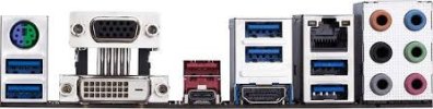

Hello Lini once again!
I managed to buy 1 of the 2 JBL 305 for 90 € second hand.
Seems like the links are working for me, thanks.
My doubts are... I get I should be a pair of cables right? Each for a monitor.
And another thing is that I found out the volume knob is always on the back and I imagibe that is going to be tedious on the long run and on the process of adaption...
Should I buy an interface or controller to connect the monitors there and then have control of them from the interface?
I imagine I should connect the new cables jack to the green and pink port right?
Thanks so much for your help and patience and sorry for my newbie questions.
No, you only need one of the cables that Lini recommended. The TRS on the 3.5mm end will get two channels, and then the 6.3mm end each has a TS with one of the channels on it. So you connect one of each of the 6.3mm TS leads to each of your speakers.
Yes that is kind of an annoyance. However, you can likely use the volume control on your PC. I would do this:
1) Turn the speaker's volume to minimum.
2) Turn the PC's volume to maximum.
3) Turn the speaker's volume up until you get to the maximum volume you would use.
4) From then on, use the PC's volume control only.
Again, you're connecting the single 3.5mm TRS end to the computer, not the two 6.3mm TS ends. The green is typically the line out and what you should connect to.

(...) My doubts are... I get I should be a pair of cables right? Each for a monitor.
Should I buy an interface or controller to connect the monitors there and then have control of them from the interface? (...)
No, as already explained by kyuu, that cable splits from 3.5 mm miniTRS stereo to two times 6.35 mm TS - so for plain 2.0 stereo you only need one.
And as also already answered by kyuu, you'd use the volume control on the PC as your main volume control in this case.
And well, a decent prosumer USB audio interface (or a decent USB DAC or USB DAC/headphone amp combo, in case you wouldn't be interested in recording anyway) would be an optional extra - but it's hard to tell, whether one of those would be worth the expense for you. Shall mean: Generally speaking modern HDA onboard sound implementations often enough already are pretty decent, foremost on the playback side, so the improvement you yould expect by adding one of those would pretty likely be quite a bit more subtle/less obvious than the improvement provided by decent speakers compared to your Logitech speaker set.

Regarding the ground loop... not sure what should I do... Maybe thats the current problem I have with my old Logitech Z506? Need the Behringer yes or yes?

Does your PC have an optical (Toslink) audio output? If it does and you are not already committed to active speakers it may be worth considering an integrated DAC/Amplifier and a pair of simple passive speakers. Having an optical connection the amp will eliminate ground loops and electrical noise from the PC completely and provide a nice flexible solution. Something like the Aiyima A80 recently reviewed here might be worth considering.
Hello Gwing!
Just some hours ago I got confirmed that my package with the JBL 305 has been lost so I have to start again.
Regarding the optical audio output, it seems my MOBO doesn't have that port and option.
