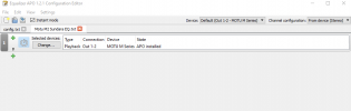

Hey Static,
I downloaded the program and saw a video on how to apply the settings to my output device which is the moto m2
So I'm guessing now it's about putting in some values?

If you are using Equalizer APO and you want to be sure it is always on, uncheck the two boxes for Exclusive Mode.

@Jackal try the GEQ that's attached to this post. It's oratory1990's GRAS KEMAR measurement of the Sundara2020 (basically identical to Amir's measurement):
EQed to the AutoEQ target (Harman OE2018 minus 2dB bass):
Here's how to load the preset into EQApo:
Afterwards you can toggle the EQ On/Off without a change in volume.
If you find there's too little/much bass, then I can adjust the target
There are two versions in the Zip: one with full correction and one that corrects only <7KHz.

Thank you I was able to DL and apply. I have almost everything set up. Waiting on the new cables and the new headphones. But now I can A/B the hell outta this :D THANKS!!!!!!!
