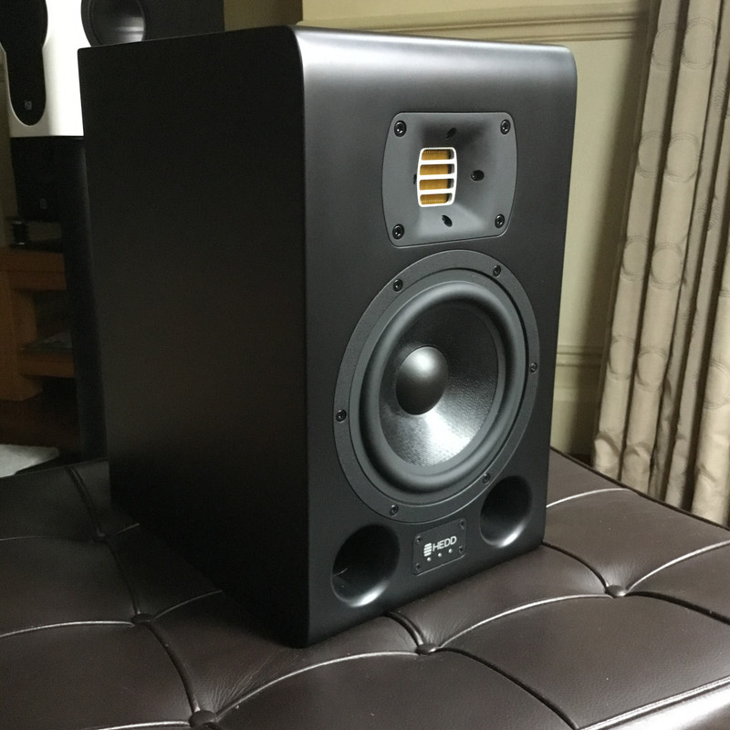

For sale a pair of black HEDD Type7 mark 2 monitors in excellent condition,
https://www.hedd.audio/products/type-07-mk2
Current price is around £1500 per pair, asking £1k ono.
Complete with boxes and all accessories.

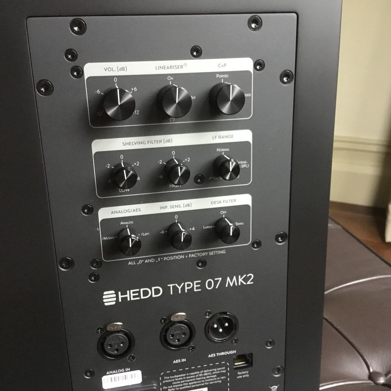

Rear view, built in phase linearisation , analogue or digital ‘in’ and other useful features,
The current version of Hedd’s type 07 monitor with built in DSP and phase linearisation, perfect condition complete with all original packaging.
