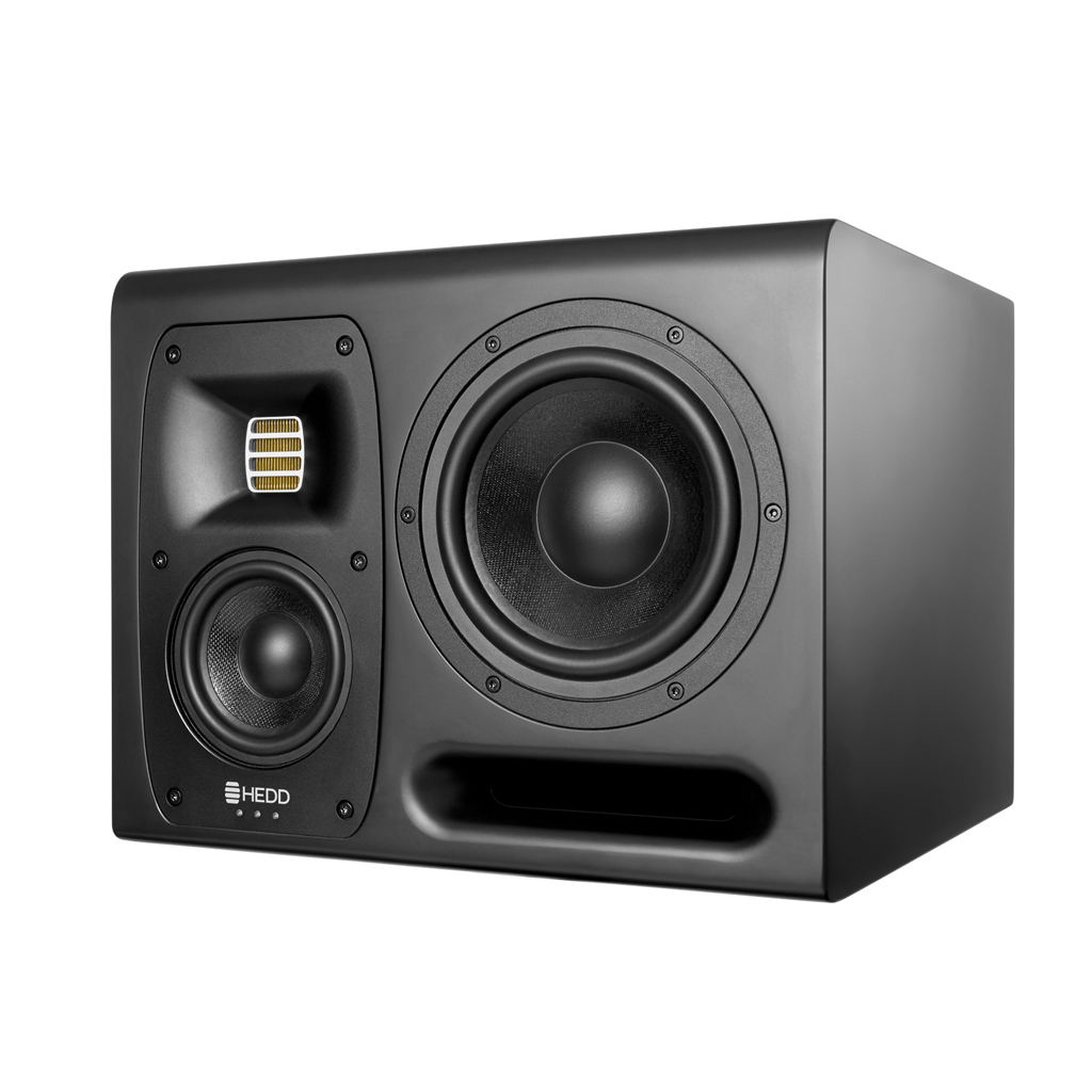

I started listening with the port closed as that was where I left off in measurements. My first female track sounded stunningly good! Not only was the tonality on the mark, it has a level of detail and presence which was a delight. I switched the linearizer on and off and the latter effect definitely diminished with it off.
What is the measured effect of that “linearizer?”
looking at those numbers (KH310s peak 390W vs Type 20s 900W), I expected the Type 20 to be able to go much much louder than the KH310 without distortion.
Well, power is only a part of the puzzle. Midrange and tweeter are too dissimilar to compare directly without any further data, however given that the HEDD has almost 20% greater volume and is ported the woofer performance does seem disappointing indeed.
Doing some estimating based on pictures by measuring pixels (breakthru scientific methods those are) the Neumann KH310 woofer has an outer surround diameter of about 188mm whereas the HEDD has about 148mm. That equals an area of 278cm² for the Neumann and 172mm² for the HEDD.
Now the results make a little more sense - the woofer on the HEDD is 7" if you include the very wide edge of the cage.
Performance isn't great even then, it still gets shown up big time by the 6.5" midwoofer on the KH150 that has numerous disadvantages working against it in that comparison.

Yep, Neumann stuck a big driver in a small box. You'll notice of course that the HD of both of them goes through the roof down low, so that's less than amazing - but for the Neumann, where there's no port, it does make sense. For the Hedd, I have to wonder about driver quality.
Especially the high distortion at 96 db in the midrange is imo concerning. The KH310 is much better here and also the KH150 despite being a 2 way design.
Not audibly distorting seems like something to expect from a modern studio monitor in this price class. So I was surprised at the recommendation.
In fairness: These are meant for use nearfield. I would not expect to need them to get particularly loud - remember, 96dB is for one speaker. I don't expect to listen that loud.

It turns out pretty much as I had expected. I've been using the MK1 of these for coming up to 5 years now. The MK1 is essentially the same except no port-closing thing, DSP is done in software, and the amplification is way more than it needs.
The HEDD Type 20s size and design looks not too far off from the KH310 (Type20: Woofer 7", Midrange: 4", Tweeter: AMT Tweeter) but it's stated power is 300W/driver. That is 900W! Looking at these numbers (KH310s peak 390W vs Type 20s 900W), I expected the Type 20 to be able to go much much louder than the KH310s without any audible distortion.
It's just that they wanted to get an mk1 out and figured 'let's just throw in this 3x300W IcePower backplate, it'll be more than enough'. By the time you hit max input at medium gain, the low end gets audibly distorted, but that's way louder that you typically want - I couldn't turn it up that high at the desk, I've only done it when sat the other end of the room, and even then it hurts after a short while. The new amplification solution should be much more appropriate, with plenty of power and at the same time should have less floor noise, which is worthwhile with sensitive AMTs in particular.

Thinking about this for the moment: The waveguide looks a lot like the JBL type horn, but sized down. It does not surprise me, then, that it's more effective than the one Adam uses on the A series.

That ultimately makes no difference, because the bit that matters most is the relative alignment of mid and tweeter, not the tweeter direction.
Made for listening in a studio, 8 hours a day at around 85 dB max. Nothing wrong with this.
The speaker is very well engineered within the bass range SPL limitations & I agree there is nothing wrong with this -----> as long is the company is forthright about it.
Yet, they spec it as being able to out SPL many competitors options available.
"Maximum SPL
120 dB SPL (sound pressure level) per pair at 1m"
This speaker simply can not meet that spec in the bass range (&especially not when sealed) and I am suspicious whether that the tweeter can play at such levels as well.
Anyway, I can think of any 7"woofers that can reproduce 120db as a pair in a 'full range' scenario. Maybe the Dayton Epique's could with 14mm xmax.
That mid runs essentially from 300 Hz to 3 kHz. I am surprised at how unhappy it gets, with broad distortion in the 500 to 800 and 2 - 3 kHz range.
