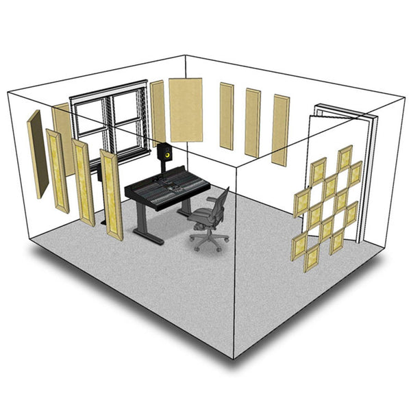

We recently looked at installing an acoustic curtain in a room at work, but the cost-performance was not great. So we installed this Primacoustic kit after determining where the specular reflections were for the listening position:
The result was quite good, especially at reducing slap echo in mid to high frequencies. After running measurements with REW, we discovered that the remaining reflective issues (other than modal resonances) were the table and computer monitor at the listening position.
